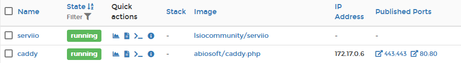

I am running version 0.11.0 in a docker container.
It was running all my web apps as a reversproxy perfectly. I changed yesterday this existing working line in Caddyfile sub1.mydomain.de {
with this: sub1.mydomain.de, sub2.mydomain.de {
After saving and restarting container it worked
I could access with both urls.
Today I was not able to connect to any web app from internet. Internal addresses are working.
all logs I checked I found nothing … Any ideas for me how to check the issue?

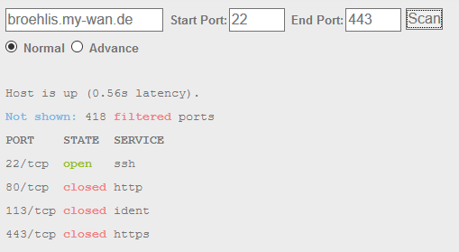

I rebooted my router and renewed port forwarding.
this is now the result of a port scan:
A “closed” port means that it is responding to packets sent by the port scanner, however no application is listening on that port.
That could be what it means. Alternately, it might mean that a firewall is denying access to the port.
Based on the information you’ve given, it seems like the Caddy host is working fine, but your NAT device isn’t working as intended.
Packets received by your router on web ports simply aren’t reaching their intended destination. On its face, the issue is describable as broken port forwarding.
From here, you could try set the Caddy host as a “DMZ host” and see if that works, or swap your NAT device for another, known good device.
