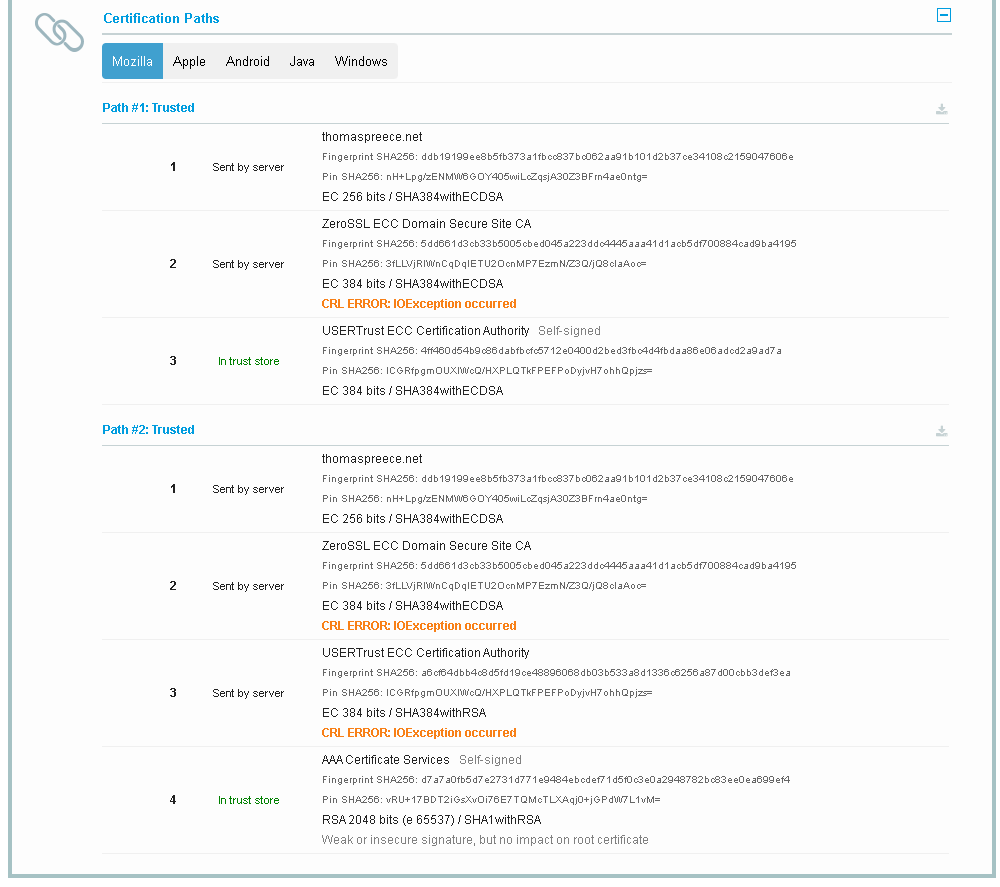

@tepreece
And here SSL Server Test: thomaspreece.net (Powered by Qualys SSL Labs) I see something I have not seen before (that could just be my experience) “CRL ERROR: IOException occurred”.
Expanding the Hide Certification PathsCertification Paths
That error doesn’t mean anything to me either unfortunately. I thought it might be useful to do the same test on one of the domains on the same server that did get a Let’s Encrypt certificate though: SSL Server Test: preecemusic.com (Powered by Qualys SSL Labs)
Same error, also on the number 2 certificate.
I tried a sample of my domains on Let’s Debug. All of them say “All OK!” for all three methods.
