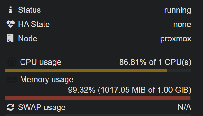

The LXC is dead now after I did press 3 times F5 :sweat_smile:
there runs caddy and nothing else.
I used mostly nginx + a little varnish so this is all new to me and I first have to get used to caddy I guess.
I’m not surprised. The brotli implementation in Go is incredibly expensive and unoptimized. I really cannot recommend it.
