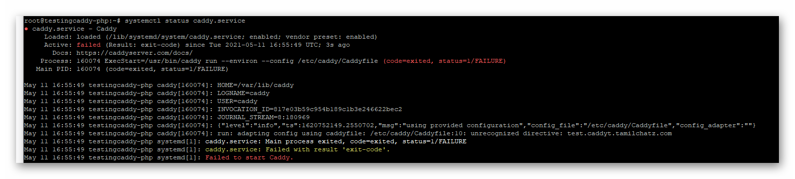

2. Error Occurred
 run: adapting config using caddyfile: /etc/caddy/Caddyfile:10: unrecognized directive: test.caddyt.tamilchatz.com
Can’t start the CADDY service at all.

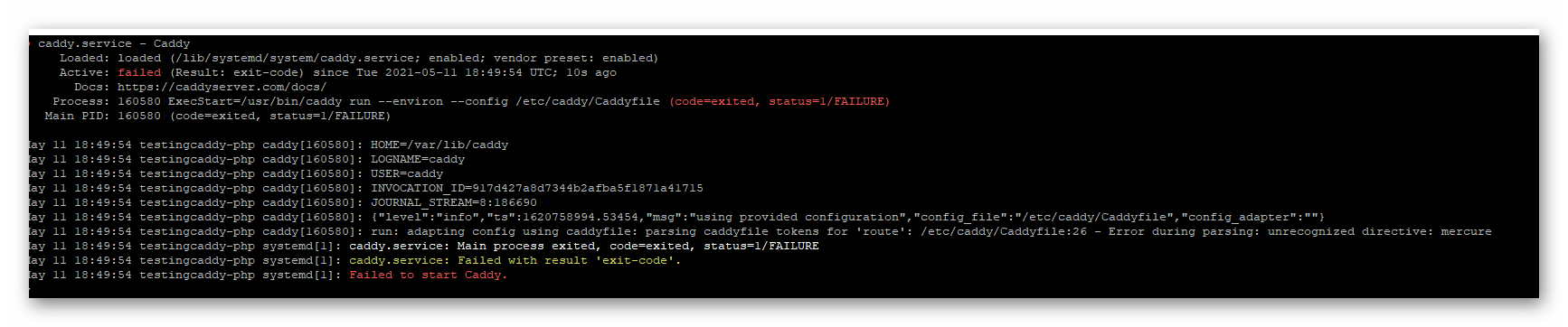

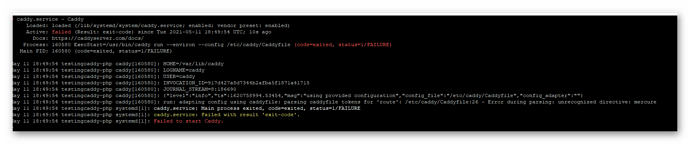

OK i have updated the code and added the right braces. Now i get another error.

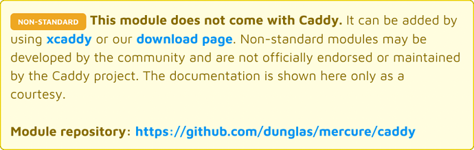

run: adapting config using caddyfile: parsing caddyfile tokens for 'route': /etc/caddy/Caddyfile:26 - Error during parsing: unrecognized directive: mercure
The mercure directive comes from a module that is NON-standard, see: Modules - Caddy Documentation
You have not filled out the help template, so the only detail I have about your system environment / install is what I can see in the screenshots. It looks like the Caddy binary you’re running via systemd is in /usr/bin/caddy.
You can double-check whether the http.handlers.mercure module is installed by running:
/usr/bin/caddy list-modules
If the module is not present, you will need to follow the xcaddy / download page links provided in the documentation to compile Caddy with the module installed before you can use it.

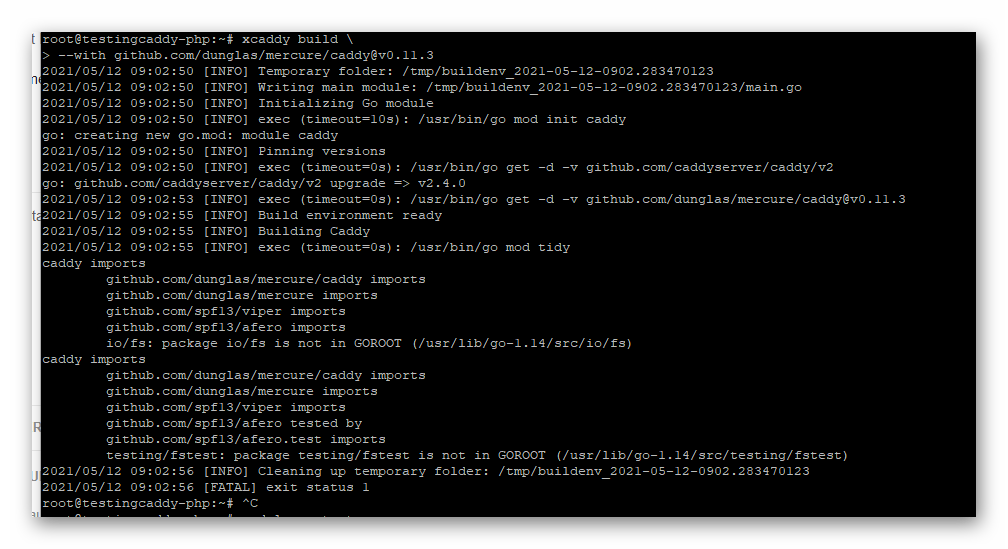

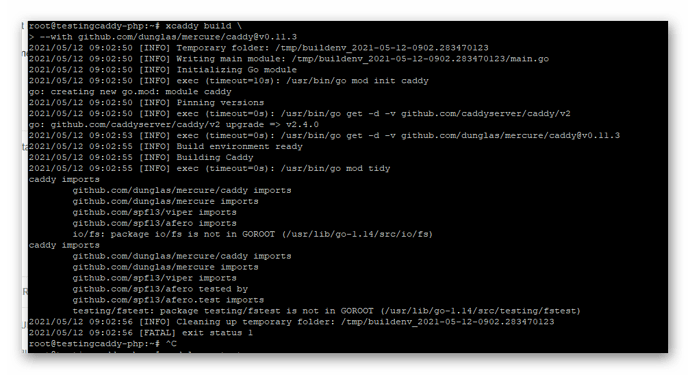

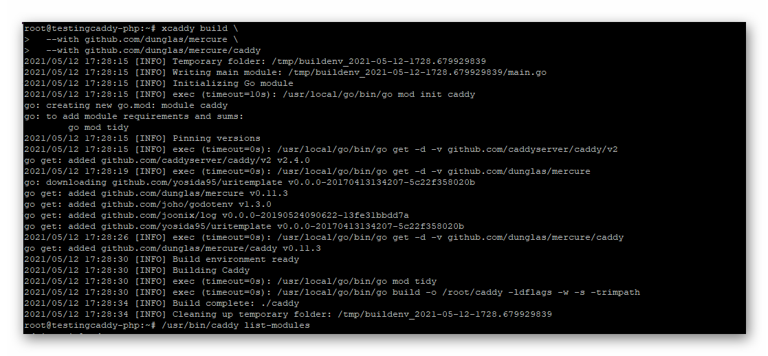

Thanks for the help, after installing xcaddy and tried to installed the module based on download page in caddy info.
But i end up getting another error.
You need to use Go version 1.15 or higher. 1.16 recommended. You’re on Go 1.14.

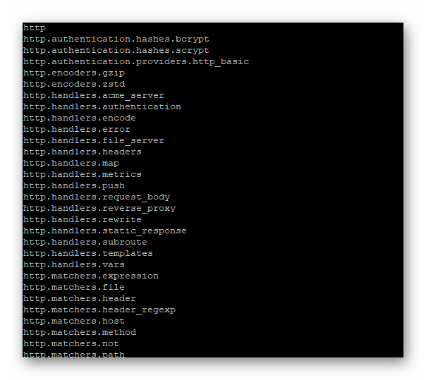

Well, i have just pumped up to the latest version of 1.16, now xcaddy works. But i get another weird issue, XCADDY says, it has installed the module “mercure”, but still can’t find it on the module list?
Now check the module list, no mercure in it.
You’ll have to ask on the mercure project repo.

xcaddy build \
  --with github.com/dunglas/mercure \
  --with github.com/dunglas/mercure/caddy
DONE that too, still nothing in the module list.
Are you in /usr/bin when you run xcaddy? If not, you’re running the wrong binary.
Yes i was in /usr/bin when running Xcaddy. But still i cant find the mercure module on the list.
Check the screenshot for /usr/bin
The previous screenshots show you in ~ (home).
Yeah i was, but now i tried your way, but still the same. Nothing helping me to get this installed. Help me out, thanks.
You need to move the caddy binary to /usr/bin/caddy after building it. Doesn’t look like you did that. By default, it outputs the binary to your current directory.
