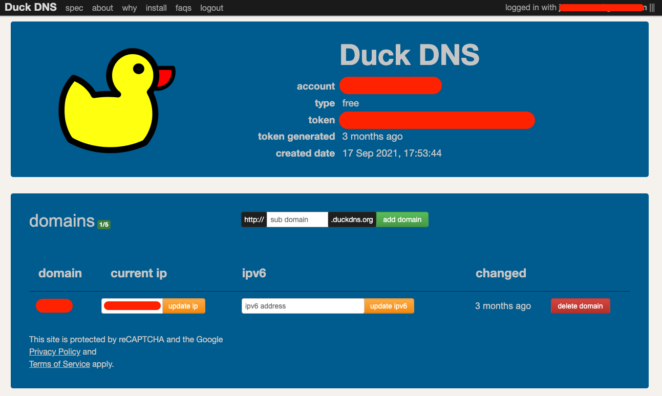

  • I have a duckdns account and registered
  • ```pifei.duckdns.org```

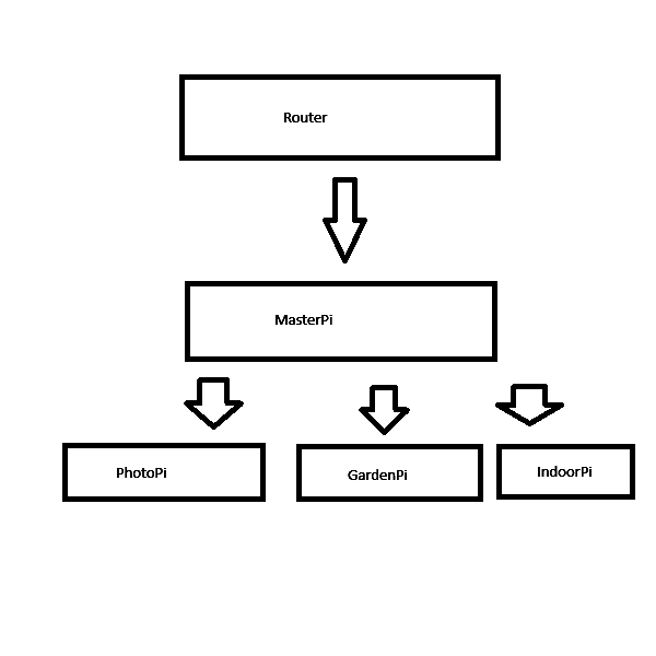

    This is what I am trying to achieve:
    I have a few raspberry pies. I would like to use one (pifei) as a central contact where I could direct traffic to the other pies (let’s call them ‘photos’, ‘indoor’ and ‘garden’) on the network They would all be subdomains of pifei.co.uk. The three pies would not need to see each other, but would all need to be accesssible from the outside world AND be https!!
    I have managed to open ports 80 and 443 and point
  • photos.pifei.co.uk
  • ``` to it, but then I am stuck because no other subdomain can use these ports AND that is where I would need caddy to come to the rescue!!
    Hope this is clear and someone can help in plain, simple terms.

Thank you for taking the time in reading my post. Newbie here regarding networking. I am more of a php, mysql, python and shell guy!
The problem is, I don’t know how to set the whole thing up.

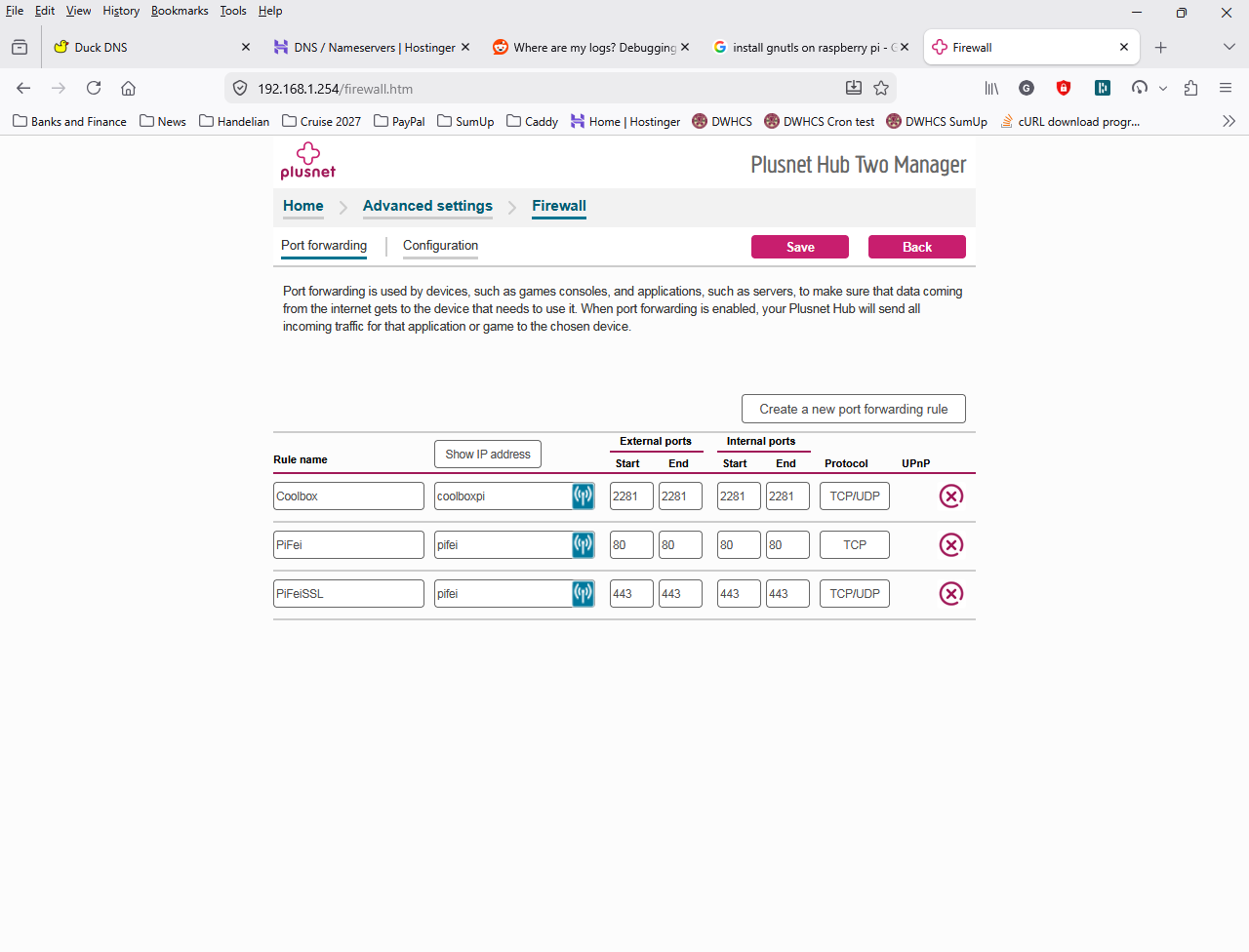

I have opened ports 80 and 443 on the router to the MasterPi, so that has https.
The MasterPi has only got Caddy installed and does not need to serve and files.
The other three pies will store files and need to be accessible from anywhere via https.
Thanks again.

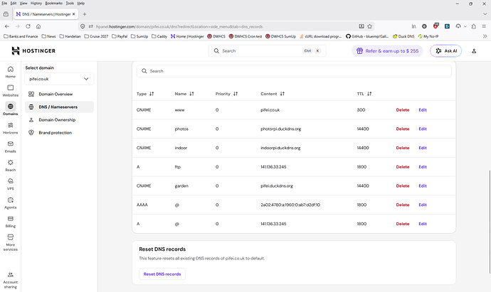

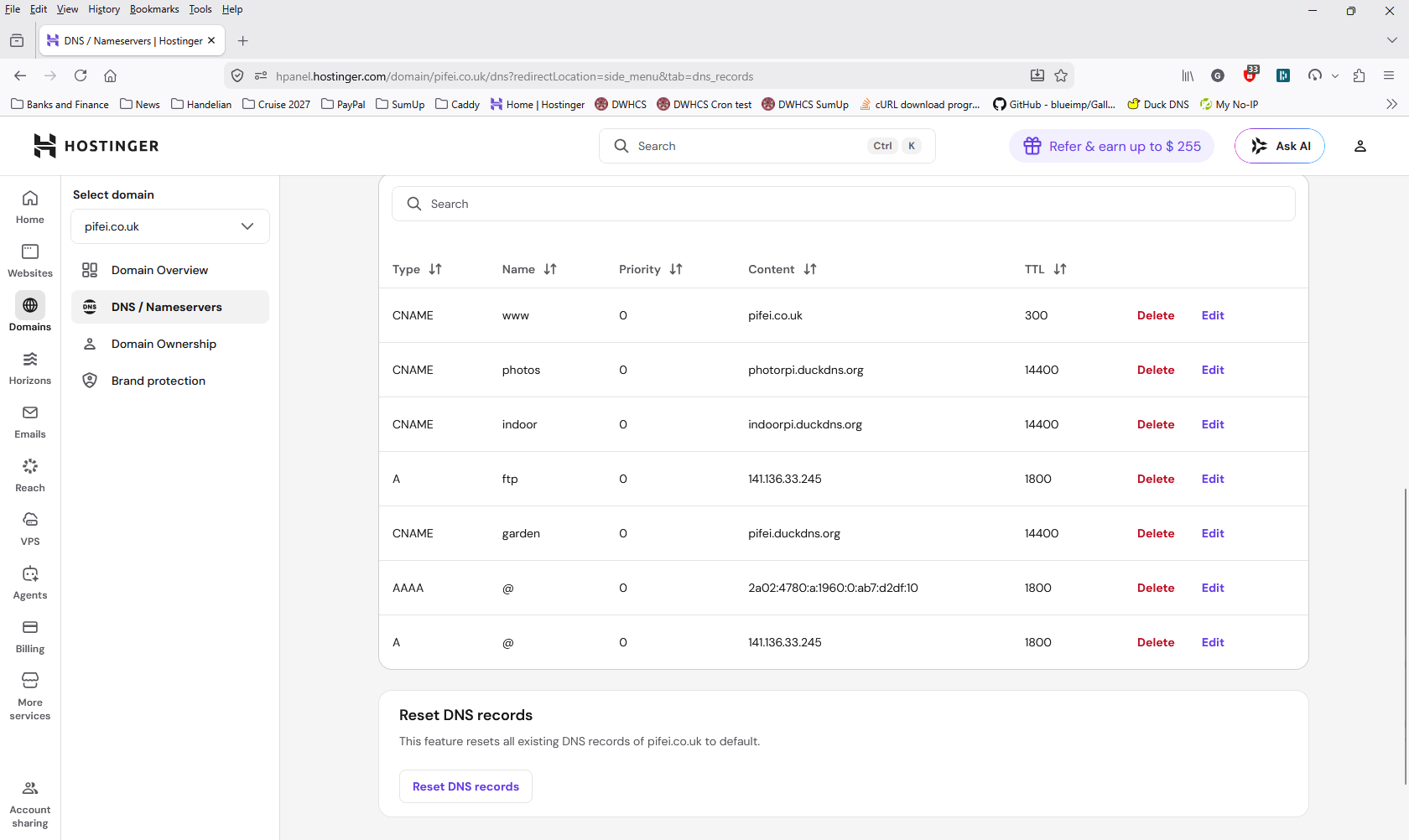

To get the other domain working, you will need to add a CNAME for indoor.pifei.co.uk to photorpi.duckdns.org. Or maybe a wildcard CNAME to pass all the hostnames to your duckdns address.
Once you have that in, what does curl -v https://indoor.pifei.co.uk show?

As I just added these subdomains, could it be that they haven’t propagated yet?
The IP resolved, so I don’t think it’s that - assuming the IP is correct. What do the logs and gnutls-cli say?

I have photorpi.duckdns.org (obviously on duckdns) and photos.pifei.co.uk (on Hostinger). photos.pifei.co.uk has a CNAME entry to photorpi.duckdns.org .

I tried curl -v http://photorpi.duckdns.org and it timed out. Perhaps you have a firewall blocking it from here. That doesn’t seem to be the same problem that you are having from your testing.

I have also forwarded 192.168.1.110 (which is the master pi) on the router to ports 80 and 443.

My route has only one port forwarding:
192.168.1.110 to 80
192.168.1.110 to 443
So, 192.168.1.110 is open on my router.

My Duckdns looks like this:
photorpi to my exterior ip address 150.143.208.218

curl -v http://photorpi.duckdns.org now completes for me with a response from caddy. https too - “Hello world”. It’s a completely different IP than before though. Are you making progress?
The https://indoor.pifei.co.uk site now returns a page from Hostinger though.

Based on the diagram posted prior only MasterPi needs to run a Caddy, and on the router port 80 and 443 to MasterPi must be forwarded/shared. MasterPi’s Caddy will then reverse proxy to PhotoPi, GardenPi and IndoorPi. This proxying does not need further firewall/router configuration since it’s all in the same local network as MasterPi. That’s what reverse proxying is: You connect to MasterPi, and MasterPi will further connect itself to the upstream addresses you specify – outsiders don’t need to know where Caddy reverse-proxies their requests. Or how.
A complete Caddyfile running on MasterPi would look like this for you:
photorpi.duckdns.org photos.feichter.co.uk {
  reverse_proxy http://192.168.1.139:<port>
indoor.pifei.co.uk indoorpi.feichter.co.uk {
  reverse_proxy http://192.168.1.246:<port>
garden.pifei.co.uk gardenpi.feichter.co.uk {
  reverse_proxy http://192.168.1.xxx:<port>
In this Caddyfile, fill in the local IP address of GardenPi in the reverse_proxy directive there. Then fill in the ports of the services running on photorpi, indoorpi and gardenpi in their respective reverse_proxy directives.

There is no port forwarding in my router.
