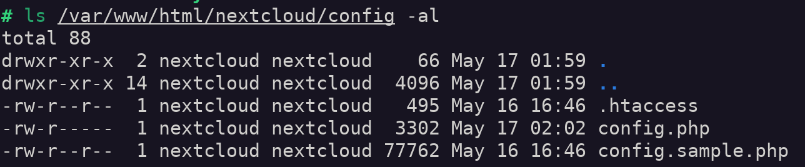

Okay, now I am stuck. I have absoluetly no clue how to get the user/group working with frankenphp to match file permissions (user/group) fpm is using.
Remember: It is a native setup with other services as well.

Nextcloud directory permissions:

  • Depending on how you installed it, the Nextcloud files should match the user/group that Caddy/FrankenPHP is running as. If you’re running it as a systemd service, then it should be owned by the caddy user, or have the www-data group at least.

As I said: You can not change the user nor the group of the FrankenPHP Worker. You can only change globally your user and give permission to everything instead of two users.
You can only use one user for everything.
The Problem here is I want to use a seperate user and group but also want to run a seperate user for the normal caddy(frankenphp) webserver
I’m not sure I understand your concern regarding users. Since FrankenPHP is Caddy+PHP in one binary, it doesn’t make sense to use two different users for that. They’re inherently tied together. What’s the actual problem here? Just make sure your Nextcloud files are usable by the caddy user.

So I have played a little bit with it and owned every folder and file to caddy:caddy.
