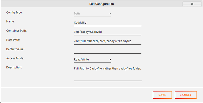

On install I get this error:
docker: Error response from daemon: OCI runtime create failed: container_linux.go:367: starting container process caused: process_linux.go:495: container init caused: rootfs_linux.go:60: mounting “/mnt/user/Docker/conf/caddyv2/Caddyfile” to rootfs at “/var/lib/docker/btrfs/subvolumes/f89f46a3e1e4fe6b6836c88b80184334ca8ff63670dc5b63c3b0e35be87d072e/etc/caddy/Caddyfile” caused: not a directory: unknown: Are you trying to mount a directory onto a file (or vice-versa)? Check if the specified host path exists and is the expected type.
The command failed.
Adding a Caddyfile to
If anyone has a working version of Caddy on Unraid would you please be able to share your contain config from the below please?
Have you actually created a file at this path in your filesystem?
The error is saying it wasn’t able to create the mount, because the file type is “unknown”.
Yes I have. The links in the above seems to have the same issue. But I am unable to recreate their solution.
and the contents of the file
Uh, looks like you made a directory named Caddyfile and then put a Caddyfile inside of that. Don’t do that! Remove the directory, and just create file called Caddyfile there.
