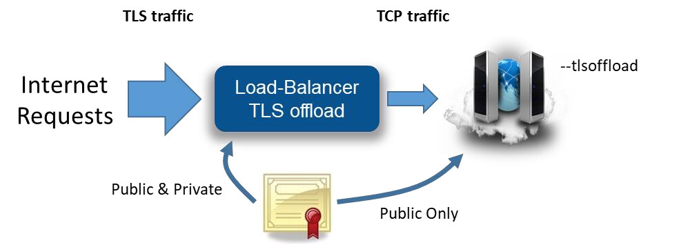

TlsOffload
By default this option is set to ‘false’. If set to ‘true’, server will run both web port and the Intel AMT MPS port without TLS with the assumption that a TLS offloading is taking care of this task. For further details, see the “TLS Offloading” section.
This option can also be set to the IP address of the reverse-proxy in order to indicate to MeshCental to only trust HTTP X-Forwarded headers coming from this IP address. See the “Reverse-Proxy Setup” section for an example.
https://meshcentral.com/docs/MeshCentral2UserGuide.pdf, Section 7.2
This would seem to indicate that you should set TlsOffload to the IP address of Caddy.
To make this work, it is important the server is setup with “–tlsoffload” not with “–notls". This indicates the server that TLS is already being taken care of and MeshCentral does not have to deal with it. MeshCentral will continue to listen to port 80, 443 and 4433.
https://meshcentral.com/docs/MeshCentral2UserGuide.pdf, Section 10
This would seem to agree.
