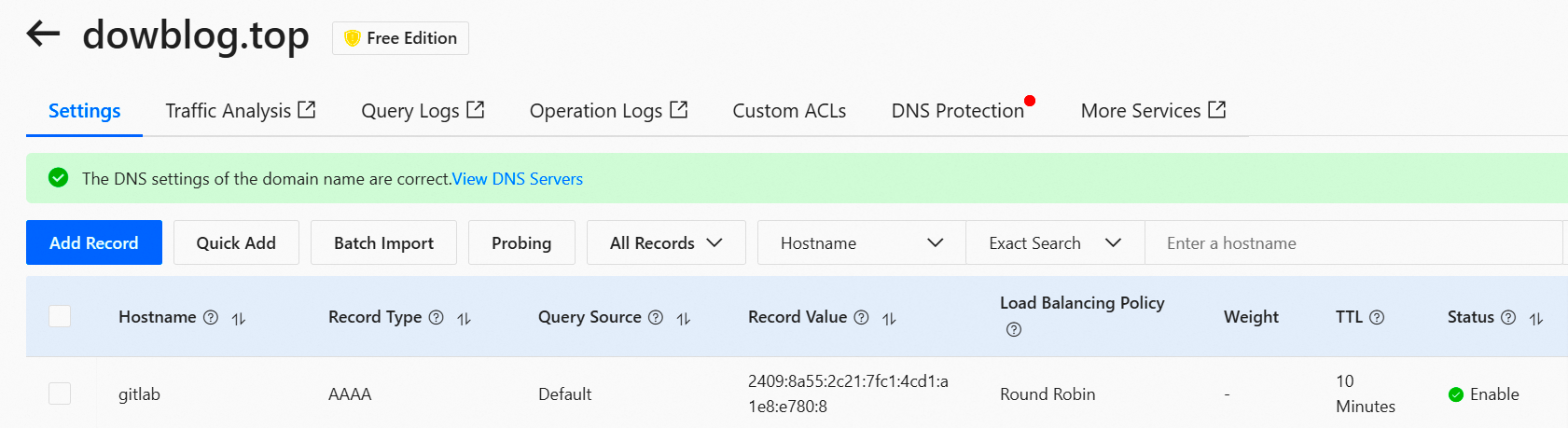

I already set my IPV6 in my DNS server and it work fine. Domain records will be updated by DDNS as scheduled for my server DOESN’T HAS ANY PUBLIC IPV4 AND STATIC IPV6.
