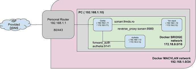

I have a stack of docker containers, and most of them are in 2 networks Bridge and MacVlan Config. I am using Caddy to reverse proxy some of this dockers.
For example the Sonarr and other *Arr stack , have the option to provide auth for requests outside of the network.
I am also using Authelia , to manage a single place to maintain authentication.
The expected outcome would be that requests proxied by Caddy , to be recognised as coming from the same network, thus not receiving the Arr auth page, and avoiding the double log in. In the same time , I want to leave the basic Arr auth in place, for the usecases that I make some mistakes, and access to those services does not pass through Caddy.
I guess that X-Fowarded-For should be populated with the Caddy ip also ? In fact , i Have no X-Forwarded-For header populated. If my understanding is incorrect I am open to suggestions.
