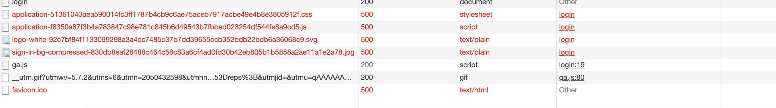

@tweeniev2 Are you able to help with serving /assets or should I create a new issue?
just remove except line.
But how do I handle that in V2. The socket from puma does not serve assets. They should come from public/assets. @tweeniev2
add
in your caddyfile.
@tweeniev2 It’s still not rendering assets
  file_server /assets/*
just file_server ?
@tweeniev2 Nope tried that first
Also tried
  file_server /assets/* {
    root /home/deploy/apps/rails-app/current/public/assets
Just a hunch, but notice the order that directives are evaluated for requests: Caddyfile Directives — Caddy Documentation
reverse_proxy is before file_server, and you don’t have a matcher on reverse_proxy, so it’s proxying all requests before it gets to file_server; in fact it never gets to file_server.
Either use a matcher to select specifically which requests you want to be proxied, or you have to use the route or handle directives. Similar to the explanation for the utility of the route directive here: route (Caddyfile directive) — Caddy Documentation
route {
    file_server /assets*
    reverse_proxy ...
