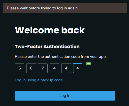

I setup the TOTP authenticator (KeePassXC) as usual and all seemed, as usual, fine.
However it’s failing 100% of the time since, when I try to login in the normal way – user + pw + totp code

I setup the TOTP 2FA (fwiw: manual code reveal to seed the authenticator), generated the backup codes and logged out.
I manually input the auth code (vs KeePassXC browser plug-in filling) and ‘please wait before trying to log in again’ – fyi, same outcome using the browser plug-in to provide the code or manually input.

The only other thing I can think of is that the failure is instant. I see no login spinner on the [ Log In ] button as I see when login to the other discourse I use.

It’s the login rate limiting. If you wait a minute then supply the TOTP code then it works.
Unless it’s considering the time I presented the name + pw creds it’s rate limiting against what?
..the 1st code entry prompt I see is failing. I tried it several times after discovering the failure, of no specific cadence, but I did attempt to account for some rate limiting by waiting.. I don’t recall the max I waited before trying again, but I probably waited ~minute, maybe longer.
I’ll give it a try again and see how it deals with an ample amount of time delay after the initial instant failure.
It’s exactly that. After you’ve entered your name/password, you can’t submit to the same endpoint (which is where the TOTP goes too) for a minute. So just wait at least a minute, make sure you submit an updated TOTP code though.
