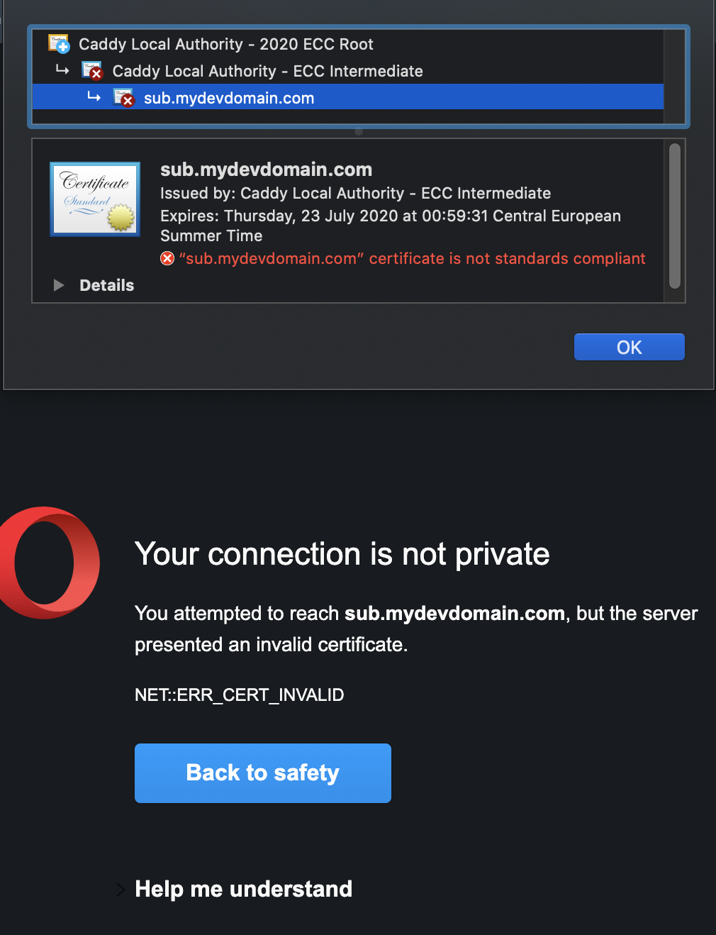

Eventually, I would like to be able to at least curl the above domain/subdomain (or similar) over HTTPS. My end goal would be to able to access those domains over in the host machine (ie: MacOS) for development, but I guess that’s a setup that goes a little beyond Caddy and is not the main topic of this issue. However, if you could tell if the TLS is likely to break when bridging from the VM to the host, that would be a nice heads up. Thanks a lot for the help!

2020/07/21 14:11:24 http: TLS handshake error from 172.17.0.1:36810: local error: tls: bad record MAC
2020/07/21 14:11:29 http: TLS handshake error from 172.17.0.1:36814: local error: tls: bad record MAC
2020/07/21 14:12:30 http: TLS handshake error from 172.17.0.1:36818: local error: tls: bad record MAC
I followed the instructions given by the curl error but I am rather new to SSL and must say I did not understand what steps they recommended to take.
