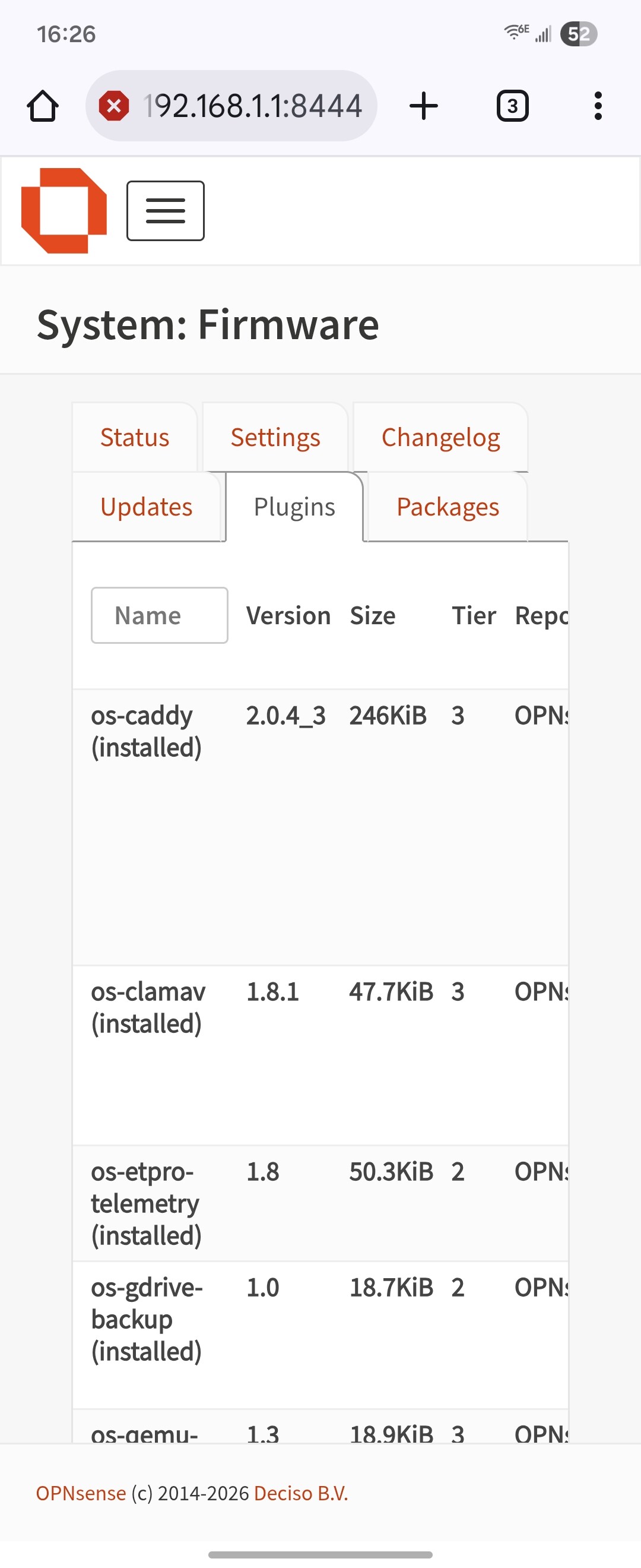

2.0.4_3
Caddy is running as a plugin to OPNsense 25.7.11
OPNsense 25.7.11
What? Are you sure? That’s insanely old, I don’t think we ship such a version.
Thats what shows on the OPNsense screen.
Ah that’s the OPNsense plugin’s version, not Caddy’s version.
