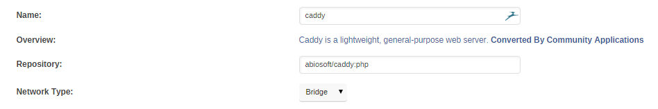

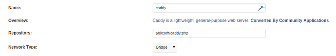

I’m trying to set up a WordPress installation I’ve been using with Nginx with Caddy. The Docker I’m using currently is this one:
I used the php variant because I don’t know if WordPress uses php or not (or whether I need it in the first place), but it seemed like a good idea because I’m also going to set up _h5ai similarly later.

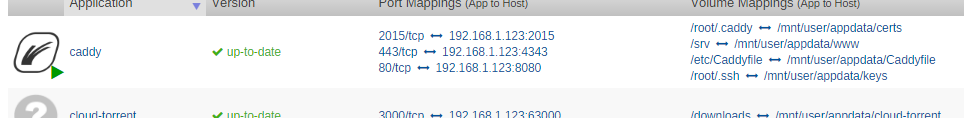

This is the error I can see on the Docker logs. Note that I’m using UnRAID with a customized Docker.
2016/11/24 07:40:14 get directory at 'https://acme-v01.api.letsencrypt.org/directory': failed to get "https://acme-v01.api.letsencrypt.org/directory": Get https://acme-v01.api.letsencrypt.org/directory: x509: failed to load system roots and no roots provided
Activating privacy features...
It spits this out, then shuts down. When I try to restart it, the above log repeats, and it shuts down.
