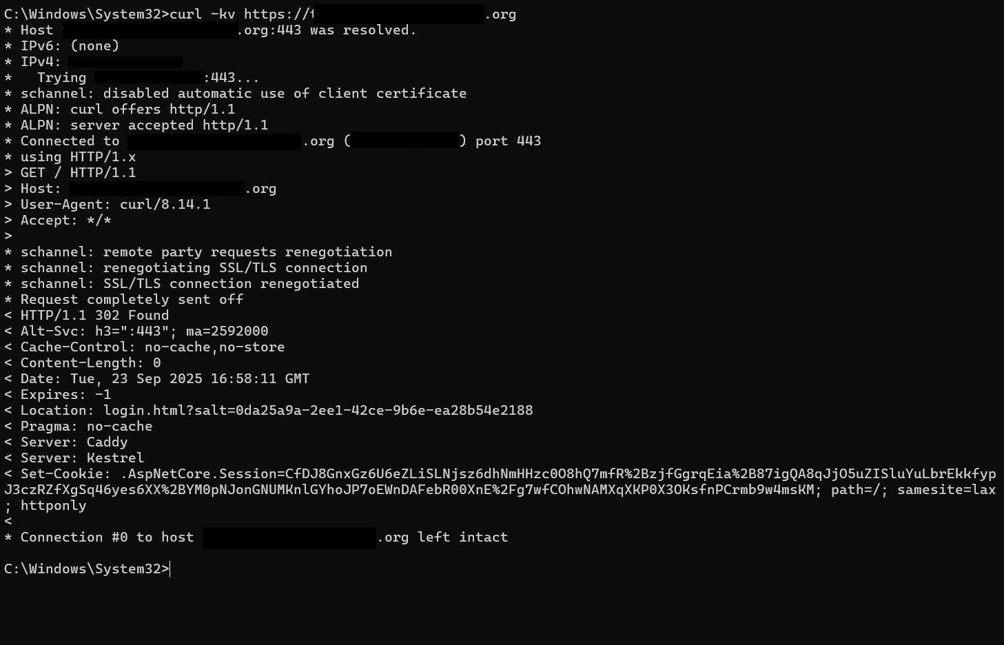

A screenshot would be helpful. Could you also share a curl output of the following?
curl -kv https://NextPVR.Domain.org
OK, it does work but I just get this not secure warning
Screenshot 2025-09-23 165440
You’re using tls internal, which is Caddy’s own internal certificate authority. This authority is not trusted by default, so you either need to add it to trusted CAs in your browser or computer, or stop using the internal CA.
