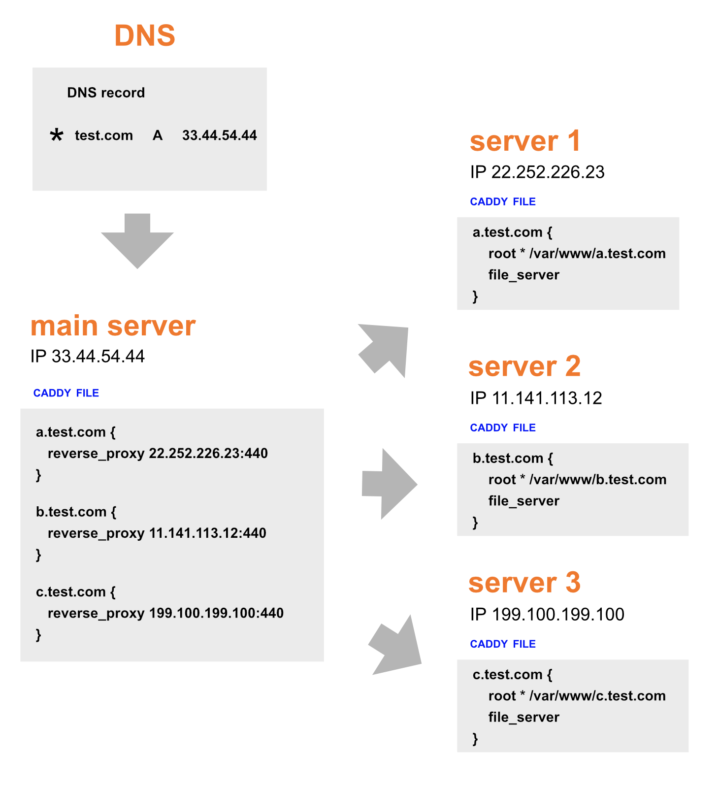

we have many subdomains and want to use a central Caddy server to redirect all requests to the subdomains to other caddy public servers. We are doing this in order to avoid creating thousands of DNS entries for each subdomain, instead we use a dns * wildcard that points to the main Caddy server
a.test.com {reverse_proxy https://12.123.12.244}
b.test.com {reverse_proxy https://12.123.12.244}
c.test.com {reverse_proxy https://12.123.12.244}

we have the main Caddy server that reverse_proxy to other Caddy servers with the same subdomains but configured as serving files with
a.test.com {
  root * /var/www/a.test.com
we have the main server with the following configuration
a.test.com {
and the receiving Caddy server at IP 12.123.12.244 configured like this:
a.test.com {

the goal is to have a main server that redirects certain subdomains to other servers
Why do you have port 440 in the reverse_proxy directive on the main server? That port does not appear anywhere in your server1, 2, or 3 Caddyfiles.

Here is a very high level version of the config based on what I can gather from your posts.
Main:
a.test.com {
    reverse_proxy https://22.252.226.23 {
        header_up Host "a.test.com"
            tls_server_name "a.test.com"
Server1:
a.test.com {
that’s perfect, exactly what we wanted to do !!! thanks a lot!!!
when users download a 1tb file located on Server1 is the bandwidth going to be consumed on the Main server as well or the Main server just redirects the query to Server1 when users type the address in the browser ?
I’ll say it in another way:
is the Main server acting like a DNS forwarder or like a tunnel where bandwidth transits through it?
Main server is a reverse proxy, so if your DNS points to the main server then all the traffic goes through the main server.
thank you!
