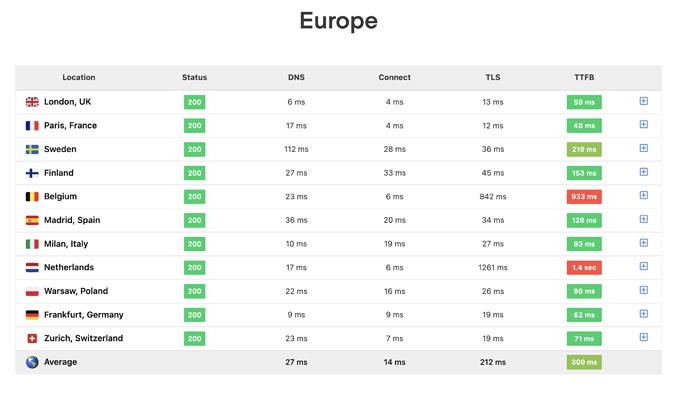

I run a Caddy cluster across US, EU, and Asia using s3fs as the shared storage, and around 500 hostnames. S3fs uses a s3 bucket in the us-east region to store certificates, ocsp and acme data. Each server uses Caddyfile configuration with default TLS parameters.
This setup works well, but the TLS negotiation from EU and Asia frequently takes between 0.5 to 1 second for hostnames that have valid certificates. I ran some tests on the s3fs directory and the latency seems to come from it having to contact us-east for the files. Once a hostname has had a few visits, it’s pretty fast until server reload.
Accessing Measure TTFB from 40 Locations - SpeedVitals shows very high TLS latency for the initial visit. Subsequent visits from different clients and different browsers in the same region are fast.
I tried manually accessing each hostname using curl to preload certificates in memory, but the results are mixed.

Ran some more tests today in a more controlled environment and logged curl timing (https://blog.cloudflare.com/a-question-of-timing/)
Tests run:
  1. Visit littlecraftstore.com and log stats
  2. Visit littlecraftstore.com again after 10 seconds with TLS cached and TCP connections intact
  3. Restart caddy, flush fs cache, wait 20 minutes to ensure that TLS cache and keepalives are expired, then revisit littlecraftstore.com and log stats
Ran this with s3fs as caddy storage, then again with a local directory as caddy storage. Here are the results: (appconnect includes TLS timing)
(All figures are seconds)
S3fs Cold request:
dnslookup: 0.000024 | connect: 0.024146 | appconnect: 0.919974 | pretransfer: 0.920095 | starttransfer: 1.081243 | total: 1.129471 | size: 62859
S3fs Subsequent request (Reusing connections, TLS cache):
dnslookup: 0.000024 | connect: 0.024311 | appconnect: 0.058072 | pretransfer: 0.058188 | starttransfer: 0.151286 | total: 0.202603 | size: 62859
S3fs request after restarting caddy and waiting 20 minutes:
dnslookup: 0.000028 | connect: 0.023603 | appconnect: 0.650617 | pretransfer: 0.650726 | starttransfer: 0.804902 | total: 0.850289 | size: 62859
Local storage cold request:
dnslookup: 0.000023 | connect: 0.024428 | appconnect: 0.060374 | pretransfer: 0.060519 | starttransfer: 0.127107 | total: 0.179072 | size: 62859
Local storage subsequent request (Reusing connections, TLS cache):
dnslookup: 0.000027 | connect: 0.024234 | appconnect: 0.057864 | pretransfer: 0.058019 | starttransfer: 0.097507 | total: 0.147492 | size: 62859
Local storage request after restarting caddy and waiting 20 minutes:
dnslookup: 0.000024 | connect: 0.023589 | appconnect: 0.059305 | pretransfer: 0.059420 | starttransfer: 0.220994 | total: 0.269670 | size: 62859
Logs suggest that the cold requests do wait for s3 to respond with the certificate instead of having certs loaded in the memory at the time of starting. Does this mean that certificate preloading is not working as it should?
