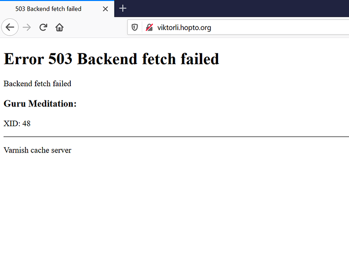

If I configure Caddyfile using http:
viktorli.hopto.org:80 {
        reverse_proxy http://192.168.200.184:6081
I get error from varnish:
I think that it could be because of the Caddy’s default reverse_proxy config and maybe I should add some settings to make it work?
