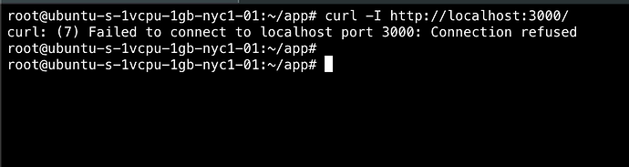

One quick way to test exactly what Caddy is seeing, when it proxies upstream for you, is to use curl. Try running this from a shell on the Caddy host:
curl -I http://localhost:3000/
Like this?
Yep. Looks like your Go app isn’t starting properly for some reason so the issue isn’t actually caddy.
That is also why you see log lines like:
lenslocked.com.service: Main process exited, code=exited, status=203/EXEC
What happens if you just try to start the Go app on the server via command line? Any error messages?
