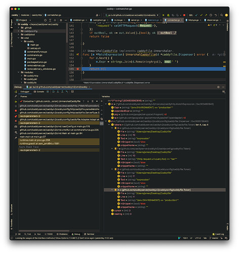

I had a crack at debugging Caddy, and I believe the problem is here:
d.tokens contains tokens for both expressions, but it tries to parse both into a single statement (m.Expr) which means the second expression overwrites the first one. Here’s a screenshot of the debug session:
You can see that while all expressions have been correctly parsed, only the ENVIRONMENT == "production" expression is retained.
I admit that multiple expressions could be composed into a single compound expression; expression "{env.ENVIRONMENT} == \"production\" && {query.foo} == \"bar\"" in this case, but having them on separate lines helps with the clarity.
I’m happy to explore a potential fix (I understand the expression module is experimental, so I expected some rough edges) or maybe propose some changes to the documentation to make it clear that multiple expressions are not supported.
