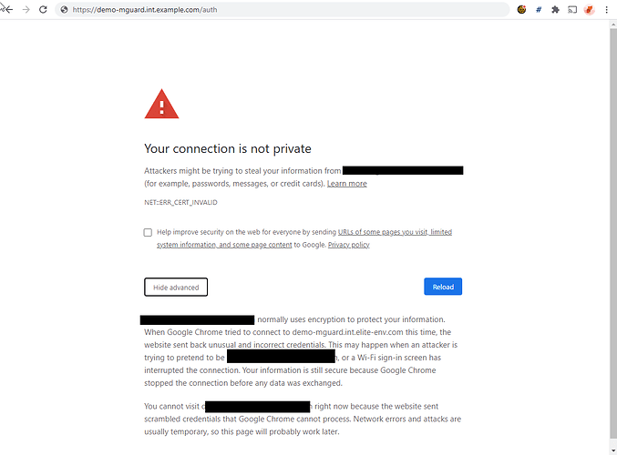

When using the local certs option of caddy for TLS, the certificate issued appears to be triggering a severe response that is beyond the normal “untrusted certificate” process a user has to go through when dealing with selfsigned/untrusted certs. In this case the broswer does not allow the user to “connect anyways” so the user can never fully connect through the proxy.
These (apparently new?) chrome TLS warnings do not allow a user to bypass the “unsecure” connection with the following warning, there is no visible way in the web page to proceed. Attempting to clear HSTS for the domain has no impact. The same alert takes place attempting to connect via IP or FQDN. Whatever is triggering the response in the browser is making the local certs implementation almost unusable?
demo-mguard.int.example.com normally uses encryption to protect your information. When Google Chrome tried to connect to demo-mguard.int.example.com this time, the website sent back unusual and incorrect credentials. This may happen when an attacker is trying to pretend to be demo-mguard.int.example.com, or a Wi-Fi sign-in screen has interrupted the connection. Your information is still secure because Google Chrome stopped the connection before any data was exchanged.
You cannot visit demo-mguard.int.example.com right now because the website sent scrambled credentials that Google Chrome cannot process. Network errors and attacks are usually temporary, so this page will probably work later.
(Note it never works)

I did identify a way to bypass this in chrome by literally clicking in the middle of the page and typing (without quotes)
thisisunsafe
And then chrome whitelists the site for the current session until chrome is restarted. But obviously that is not a usable solution. (thanks stackoverflow!)
where I found where to get past the warning in chrome (not exact same issue, but still provides bypass that allows this to work)
