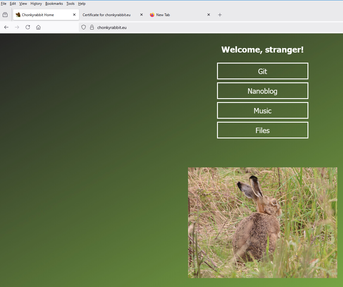

Right after I just created this topic, I noticed that my website was reachable again, probably via zerossl so apparently I just had to wait a few minutes …? I’d still like to know what’s wrong though.

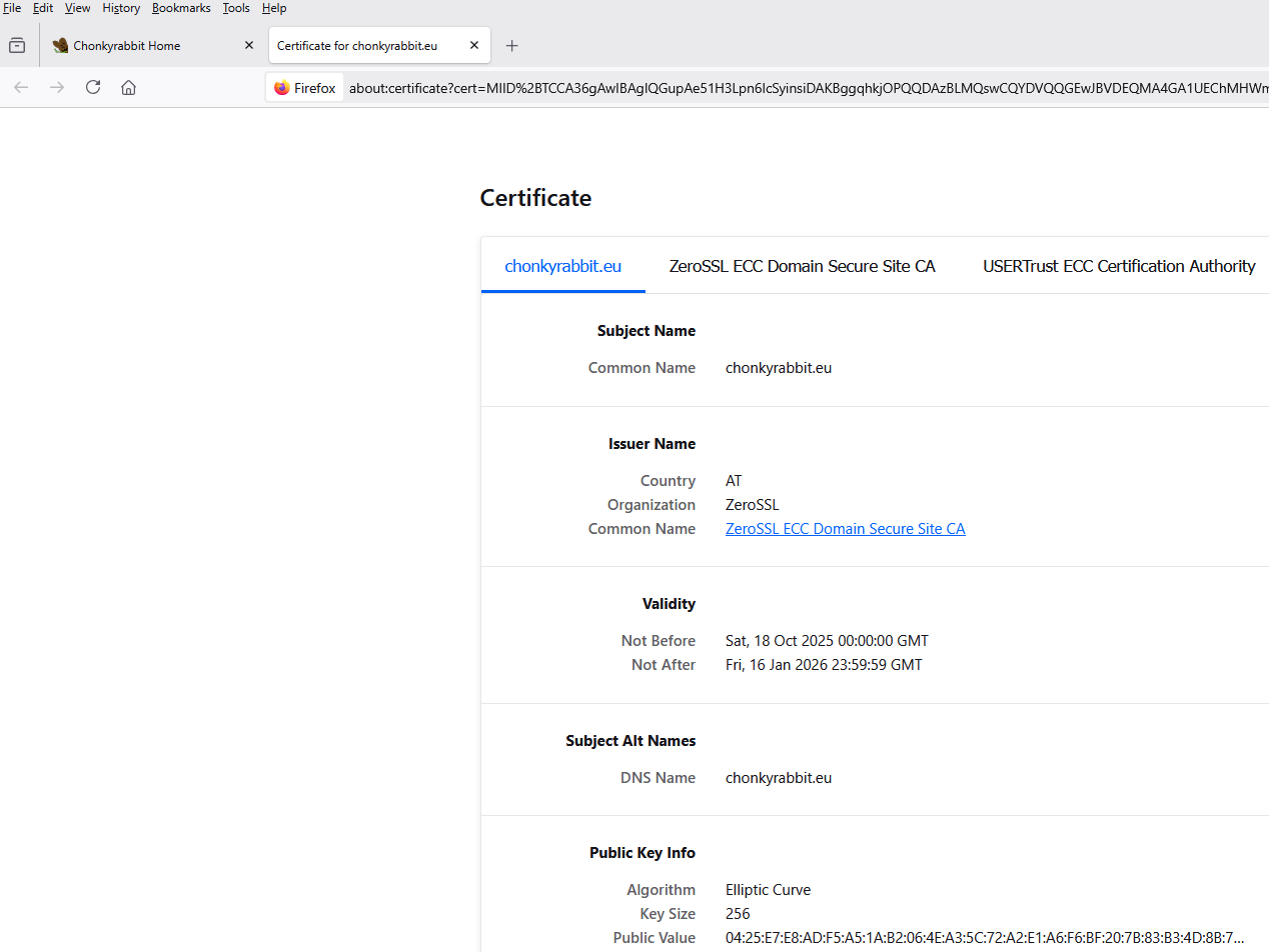

Here is a list of issued certificates https://crt.sh/?q=chonkyrabbit.eu.
The certificate presently being served is https://crt.sh/?id=21798859664
openssl s_client -showcerts -servername chonkyrabbit.eu -connect chonkyrabbit.eu:443 < /dev/null
$ openssl s_client -showcerts -servername chonkyrabbit.eu -connect chonkyrabbit.eu:443 < /dev/null

0 s:CN = chonkyrabbit.eu
i:C = AT, O = ZeroSSL, CN = ZeroSSL ECC Domain Secure Site CA
a:PKEY: id-ecPublicKey, 256 (bit); sigalg: ecdsa-with-SHA384
v:NotBefore: Oct 18 00:00:00 2025 GMT; NotAfter: Jan 16 23:59:59 2026 GMT

https://unboundtest.com/m/TXT/_acme-challenge.chonkyrabbit.eu/TE47CIS5 shows
2 TXT _acme-challenge.chonkyrabbit.eu records, typically ACME Clients clean up after themselves by removing the TXT records after the certificate(s) have been issued.
Doesn’t seem to have this time.

And Firefox 144.0 (64-bit) on Windows 10 I do not see such an error.
I see
And no issues using Chrome Version 141.0.7390.77 (Official Build) (64-bit)
