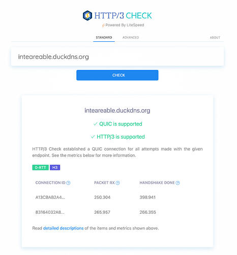

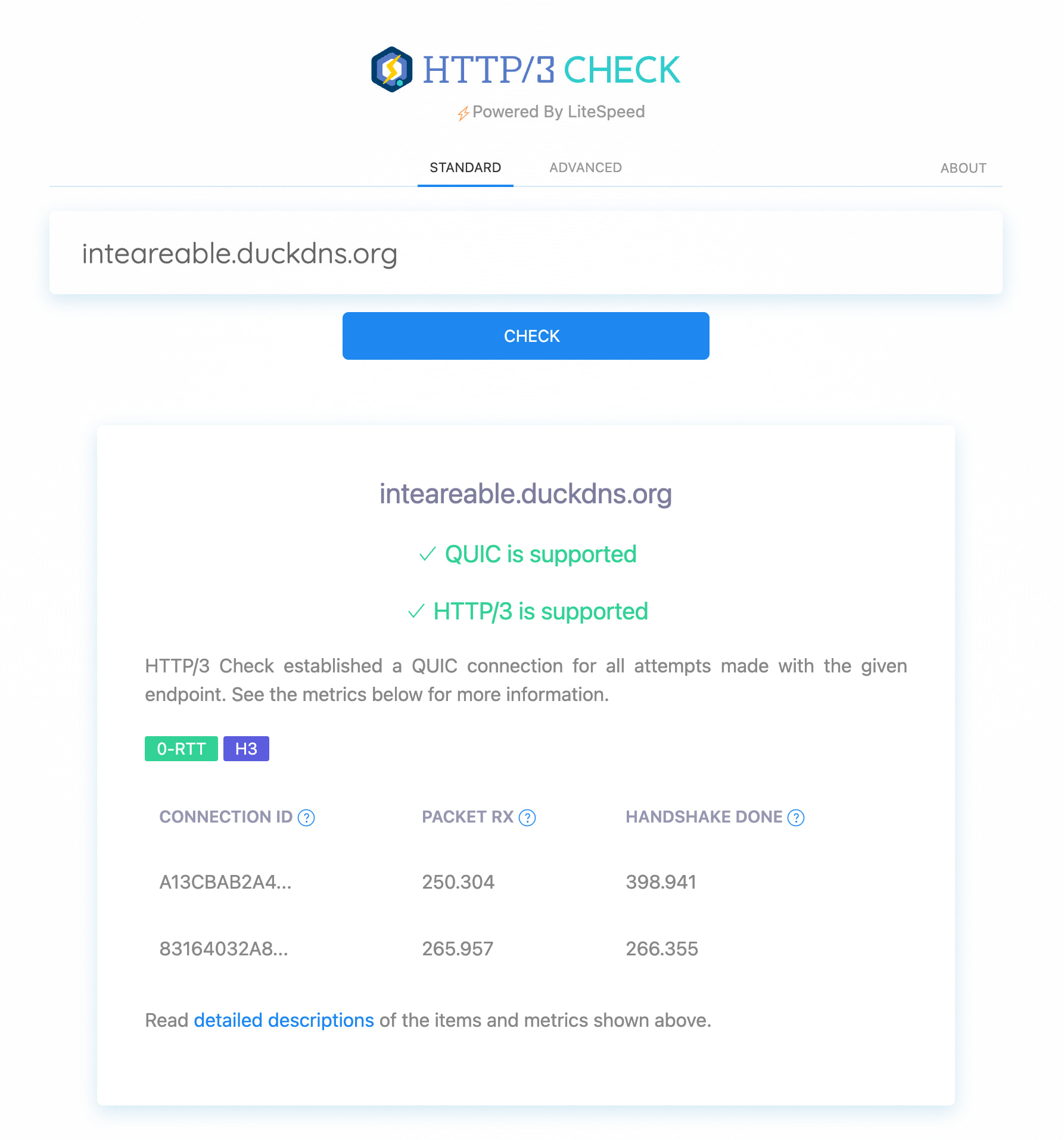

As far as I can tell, your HTTP/3 works fine:
Here’s the relevant part of my setup:

When I check it with curl, it says HTTP/3:
$ curl -sI --http3-only https://mysite.mydomain.com | grep -iE 'http|h3'
HTTP/3 200
alt-svc: h3=":443"; ma=2592000
