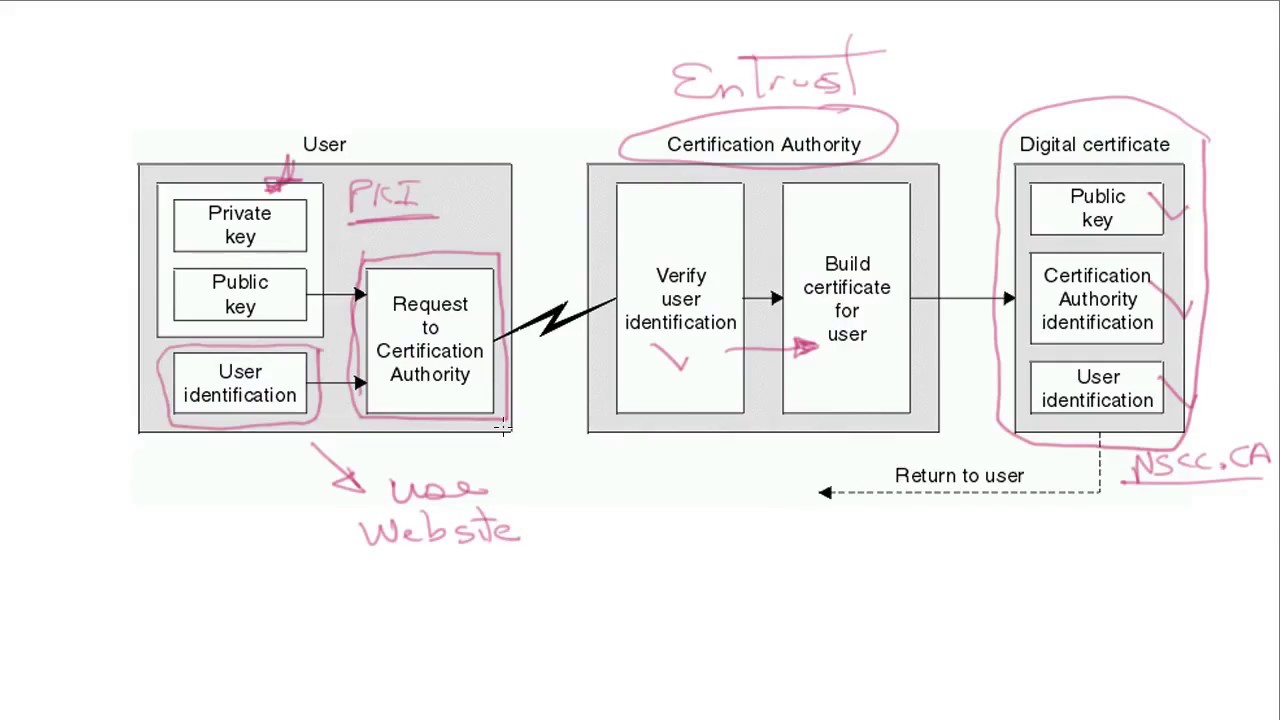

Watch the following guides to understand the basics HTTPS, Certificate Authorities, certificates and trust. Realize that caddy server is acting as the CA for issuing a certificate on demand to itself for the host you are configuring it on. When it does this on windows it installs the CA into the local windows user’s trust. But that locally installed trust wont work if you are running your browser on a different computer.
Intro to digital certificates
Digital Certificates: Chain of Trust
