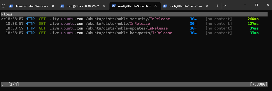

I did not find a way with a vanilla Caddy, BUT there is a great tool that can help: mitmproxy. In my case, Caddy is running as a reverse proxy for a server listening on port 8080. So I changed the server configuration to listen on port 8081 and I started mitmproxy this way:
mitmproxy -p 8080 --mode reverse:http://localhost:8081/
It is more effort to set up than logging, and it causes an interruption of the service, but the upside is that there is a nice user interface to navigate between the requests and all the details.
https://www.chrissearle.org/_ipx/_/images/posts/2020/12/mitm-curl-response.png (sorry, I do not have the right to embed more than one image as a new user).
You can even replay the requests, with or without modification…

Oh OK, thanks! I tried it but it did not work. I will try again when I have an opportunity.
Still, mitmproxy is a interesting alternative because it is much more user-friendly and powerful with its UI.
