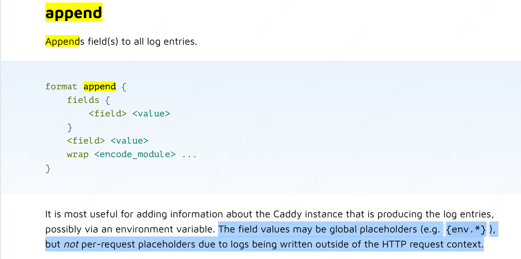

I noticed that the caddy doc says that it supports only global placeholders (e.g. {env.*} ), as shown in the picture:
So does it mean that we are unable to append such information into the access log? Is there any way that I can realize this requirement?
Thanks in advance!
