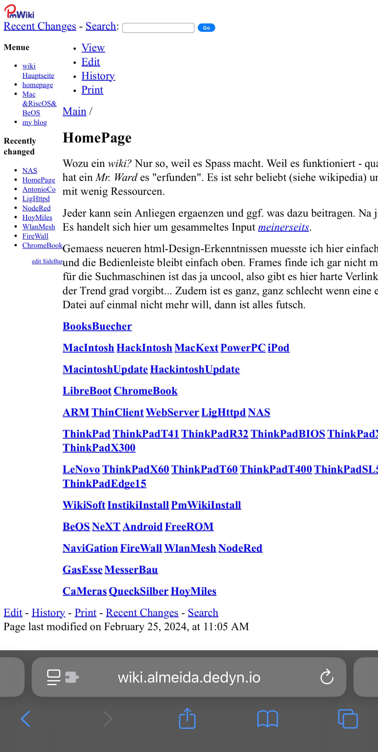

Trying to setup reverse_proxy for php-based wiki running on a second local server. Wiki is displayed, but layout is corrupted. I’m not sure if caddy have to be configured to display php, instead of “normal” reverse_proxing

But site is displayed and I can move through the posts, only layout is not correct.
I assume the style-sheets and templates are not accessible. There is no firewall. "web"server is netbsd 9.3.

Y can browse it, too: https://wiki.almeida.dedyn.io . Template should be “minimous”, but it isn’t working -->like https://www.pmwiki.org/pmwiki/uploads/Skins/minimous_screenshot.jpg
I can’t access it. I’m getting an HTTP 502 error, same as what you’re seeing in your error log.

OK, something’s changed since the last time I tried your wiki site. Before, I was getting an HTTP 502 error. Now, I’m seeing this content:

sorry, I set php-wiki in config to “front”. locally it is displayed correctly

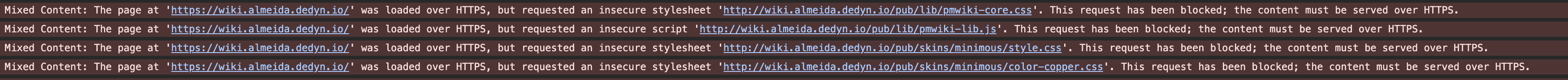

You’re exactly right.
Your wiki page is being served over HTTPS, but the HTML generated by your backend has hardcoded absolute URLs using HTTP. For example:
<link rel="stylesheet" type="text/css" href="http://wiki.almeida.dedyn.io/pub/lib/pmwiki-core.css" />
<script type="text/javascript"  src="http://wiki.almeida.dedyn.io/pub/lib/pmwiki-lib.js"></script>
<title>wiki Main/Home Page</title>
<link rel="stylesheet" type="text/css" href="http://wiki.almeida.dedyn.io/pub/skins/minimous/style.css" media="screen" title="style (screen)" />
<link rel="stylesheet" type="text/css" href="http://wiki.almeida.dedyn.io/pub/skins/minimous/color-copper.css" media="screen" title="style (screen)" />
Browsers don’t like that .. it’s called a mixed content issue.
If you check your browser’s console, you’ll see a bunch of these warnings:
So, what can you do? The PmWiki Troubleshooting page covers this
They mention this situation specifically:
After some upgrades to website, hosting, or browser, some skin styles/colors and possibly local styles, recipes, and embedded pictures, have stopped working.
In your local configuration, if you have the variables $PubDirUrl or $FarmPubDirUrl defined with the http:// scheme, replace them with https://. On secure websites, recent browser versions do not load resources from insecure URLs.
Switching those URLs to HTTPS should solve the issue.
Great, thats the difference if a pro helps - I never suppose that simple “s” does the trick… Thx a lot works :+1:
