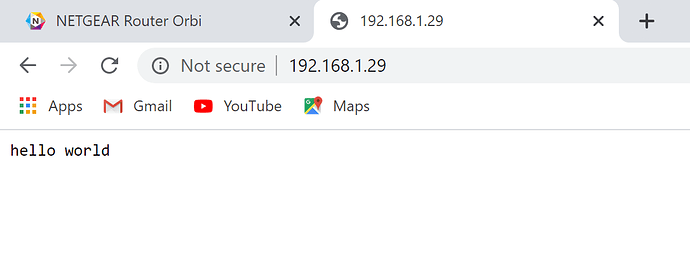

Hey there’s progress!!!
Ok my Caddyfile now has:
http://192.168.1.29
respond “hello world”
Now both browsers respond

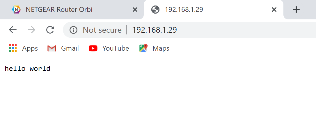

here’s a pic
