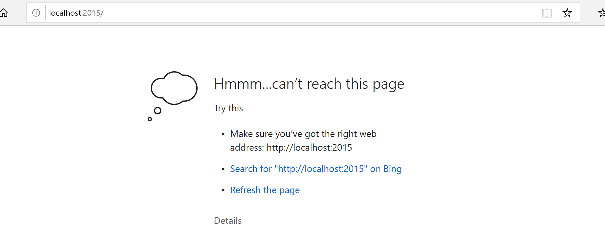

And here’s what my browser says when I type localhost:

Yup I did it without 2015. It automatically adds the 2015 onto it in the www bar after I hit enter. All I type is localhost and I’ve tried it with 127.0.0.1.
I’ve also tried it with localhost:80 localhost:443 127.0.0.1:80 127.0.0.1:443 127.0.0.1:2015. I have tried so many different variations throughout the day. I have made sure Caddy was actually running while doing it also. I’ve changed the localhost in Caddyfile to my duckdns and tried typing that into the browser also.
Sounds like your browser has a permanent redirect cached for localhost:80 → localhost:2015.
Try in another browser, or try https://localhost directly.

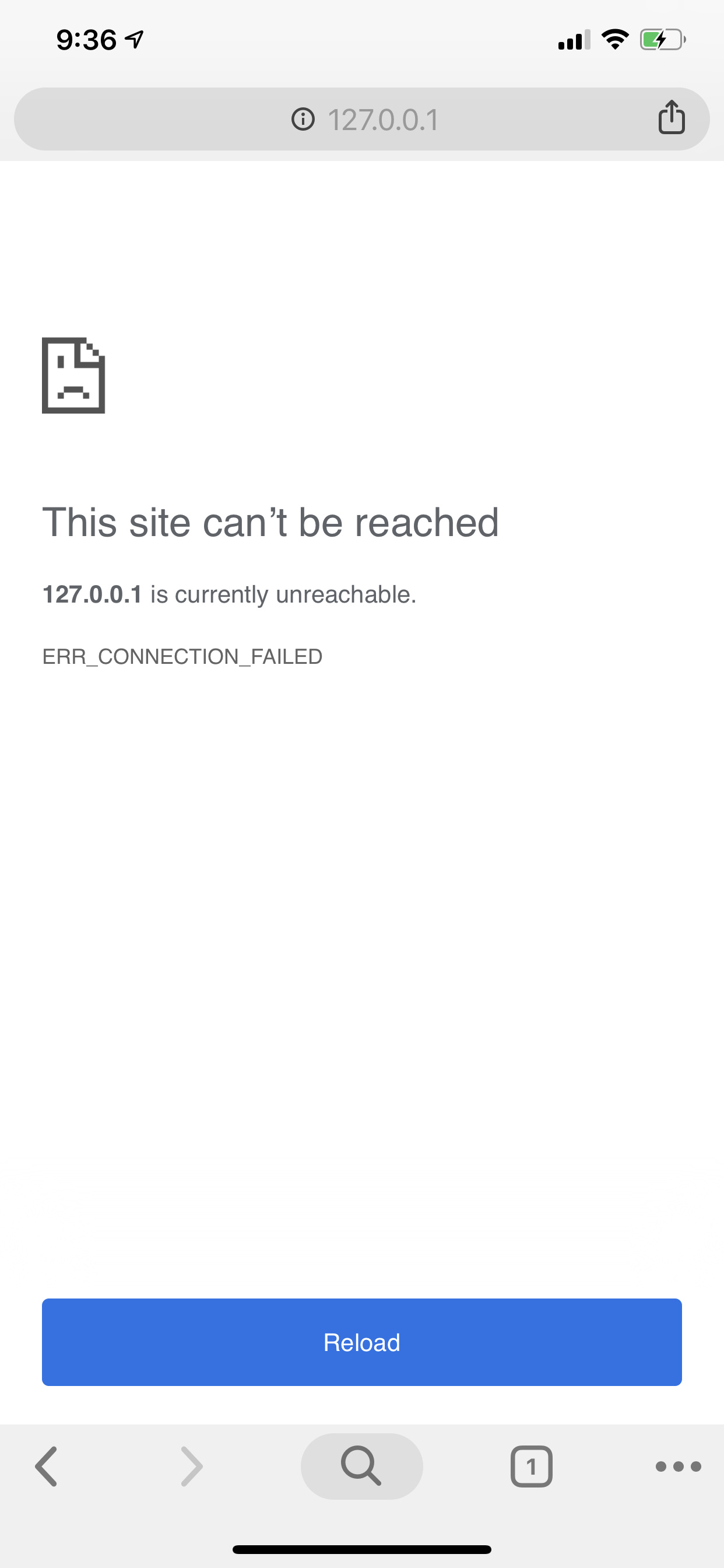

I tried my Chrome browser on the laptop a couple times and got errors. I just tried from my phone also.
I should be able to get there from my phone I would assume.
Which computer does Caddy run on?
Both localhost and 127.0.0.1 are loopback addresses. They allow a computer to refer to itself.
So connecting to localhost on your phone would require you to have a web server running on the phone itself.
You need to connect to localhost in a browser open on the computer you’re running Caddy on, i.e. the Pi.
Oh well maybe that’s the problem…my Pi is headless and I’m using Putty from Windows to do stuff to it. I’ve been using my Windows browser to try to access localhost.

The issue was you were connecting your own localhost, not the Pi localhost.
I guess you have a proxy config on your Edge browser (that redirection to localhost:2015). But anyway, you solved the caddy issue.
