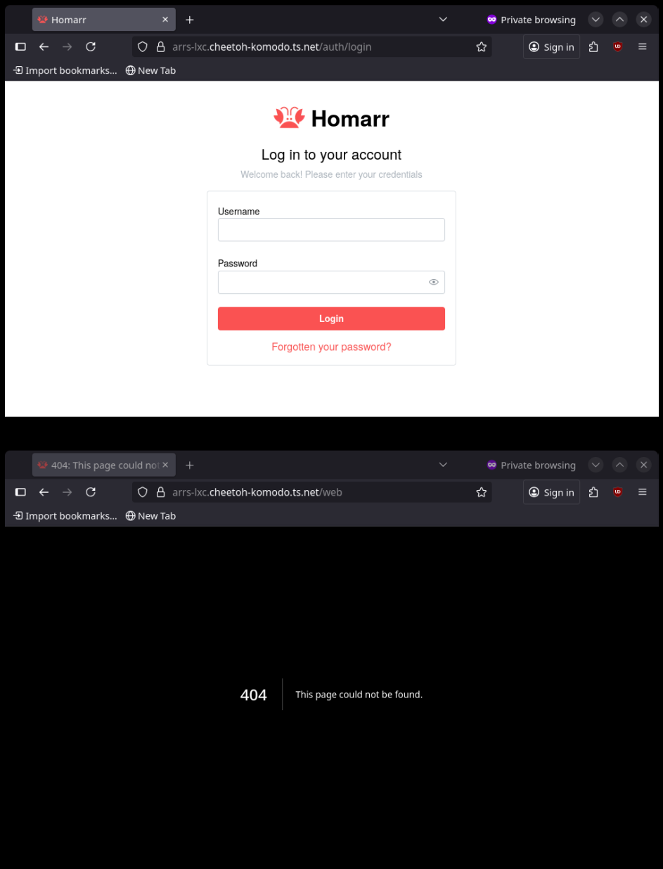

I am having trouble getting Caddy to behave the way I want it to for my homelab. For some context, I have a PC running Proxmox, and on that I have an Ubuntu Server LXC container and inside of that I have Docker installed. For the example in this post, I am using Docker Compose to run three containers: Caddy, Homarr, and Jellyfin. I have Tailscale installed directly in Ubuntu, as that’s the way I want to access my services (I am using Tailscale with Caddy to be able to access my homelab services while having HTTPS in the browser).
What I’m trying to do:
  • Typing arrs-lxc.cheetoh-komodo.ts.net (tailnet address of my LXC) in the browser leads to arrs-lxc.cheetoh-komodo.ts.net/auth/login, and my Homarr dashboard displays properly, saying the connection is secure.
  • However, typing arrs-lxc.cheetoh-komodo.ts.net/jellyfin leads to https://arrs-lxc.cheetoh-komodo.ts.net/web and I get a black screen saying “404 | This page could not be found”
If it helps, here are the url’s I get from accessing Homarr and Jellyfin using their private ip addresses:
  • Homarr: http://192.168.7.252:7575/auth/login
  • Jellyfin: http://192.168.7.252:8096/web/#/wizardstart.html
The goal is to access my services in this way:
arrs-lxc.cheetoh-komodo.ts.net (brings up the Homarr dashboard)
arrs-lxc.cheetoh-komodo.ts.net/jellyfin (access jellyfin web ui)
arrs-lxc.cheetoh-komodo.ts.net/sonarr (access sonarr web ui)
etc.
I have looked at other Caddy forum posts but I have not been able to get it working.
Thank you in advance for any help :grinning_face_with_smiling_eyes:
Trying to access Homarr (top image) and Jellyfin (bottom image):

DBG ts=1760427393.202912 logger=http.handlers.rewrite msg=rewrote request request={"remote_ip":"100.70.251.50","remote_port":"46384","client_ip":"100.70.251.50","proto":"HTTP/2.0","method":"GET","host":"arrs-lxc.cheetoh-komodo.ts.net","uri":"/","headers":{"Sec-Fetch-Site":["none"],"Sec-Fetch-User":["?1"],"Priority":["u=0, i"],"User-Agent":["Mozilla/5.0 (X11; Linux x86_64; rv:143.0) Gecko/20100101 Firefox/143.0"],"Sec-Gpc":["1"],"Cookie":["REDACTED"],"Upgrade-Insecure-Requests":["1"],"Sec-Fetch-Dest":["document"],"Sec-Fetch-Mode":["navigate"],"Te":["trailers"],"Accept":["text/html,application/xhtml+xml,application/xml;q=0.9,*/*;q=0.8"],"Accept-Language":["en-US,en;q=0.5"],"Accept-Encoding":["gzip, deflate, br, zstd"]},"tls":{"resumed":false,"version":772,"cipher_suite":4865,"proto":"h2","server_name":"arrs-lxc.cheetoh-komodo.ts.net"}} method=GET uri=/
DBG ts=1760427393.202994 logger=http.handlers.reverse_proxy msg=selected upstream dial=jellyfin:8096 total_upstreams=1
DBG ts=1760427393.2059207 logger=http.handlers.reverse_proxy msg=upstream roundtrip upstream=jellyfin:8096 duration=0.002891123 request={"remote_ip":"100.70.251.50","remote_port":"46384","client_ip":"100.70.251.50","proto":"HTTP/2.0","method":"GET","host":"arrs-lxc.cheetoh-komodo.ts.net","uri":"/","headers":{"Upgrade-Insecure-Requests":["1"],"Accept-Encoding":["gzip, deflate, br, zstd"],"Te":["trailers"],"Via":["2.0 Caddy"],"Sec-Fetch-Dest":["document"],"X-Forwarded-For":["100.70.251.50"],"Sec-Fetch-User":["?1"],"Priority":["u=0, i"],"Sec-Gpc":["1"],"Sec-Fetch-Mode":["navigate"],"X-Forwarded-Proto":["https"],"X-Forwarded-Host":["arrs-lxc.cheetoh-komodo.ts.net"],"Accept":["text/html,application/xhtml+xml,application/xml;q=0.9,*/*;q=0.8"],"Accept-Language":["en-US,en;q=0.5"],"Sec-Fetch-Site":["none"],"User-Agent":["Mozilla/5.0 (X11; Linux x86_64; rv:143.0) Gecko/20100101 Firefox/143.0"],"Cookie":["REDACTED"]},"tls":{"resumed":false,"version":772,"cipher_suite":4865,"proto":"h2","server_name":"arrs-lxc.cheetoh-komodo.ts.net"}} headers={"Location":["web/"],"Content-Length":["0"],"Date":["Tue, 14 Oct 2025 07:36:32 GMT"],"Server":["Kestrel"]} status=302
DBG ts=1760427393.218726 logger=http.handlers.reverse_proxy msg=selected upstream dial=homarr:7575 total_upstreams=1
DBG ts=1760427393.2228367 logger=http.handlers.reverse_proxy msg=upstream roundtrip upstream=homarr:7575 duration=0.004072736 request={"remote_ip":"100.70.251.50","remote_port":"46384","client_ip":"100.70.251.50","proto":"HTTP/2.0","method":"GET","host":"arrs-lxc.cheetoh-komodo.ts.net","uri":"/web/","headers":{"User-Agent":["Mozilla/5.0 (X11; Linux x86_64; rv:143.0) Gecko/20100101 Firefox/143.0"],"Accept-Encoding":["gzip, deflate, br, zstd"],"Sec-Gpc":["1"],"X-Forwarded-Proto":["https"],"Sec-Fetch-Dest":["document"],"Sec-Fetch-Mode":["navigate"],"Sec-Fetch-User":["?1"],"Priority":["u=0, i"],"Te":["trailers"],"Accept":["text/html,application/xhtml+xml,application/xml;q=0.9,*/*;q=0.8"],"Upgrade-Insecure-Requests":["1"],"Sec-Fetch-Site":["none"],"Cookie":["REDACTED"],"Accept-Language":["en-US,en;q=0.5"],"X-Forwarded-For":["100.70.251.50"],"X-Forwarded-Host":["arrs-lxc.cheetoh-komodo.ts.net"],"Via":["2.0 Caddy"]},"tls":{"resumed":false,"version":772,"cipher_suite":4865,"proto":"h2","server_name":"arrs-lxc.cheetoh-komodo.ts.net"}} headers={"Server":["nginx/1.28.0"],"Date":["Tue, 14 Oct 2025 07:36:33 GMT"],"Connection":["keep-alive"],"Location":["/web"],"Refresh":["0;url=/web"]} status=308
DBG ts=1760427393.2305684 logger=http.handlers.reverse_proxy msg=selected upstream dial=homarr:7575 total_upstreams=1
DBG ts=1760427393.2481015 logger=http.handlers.reverse_proxy msg=upstream roundtrip upstream=homarr:7575 duration=0.017486602 request={"remote_ip":"100.70.251.50","remote_port":"46384","client_ip":"100.70.251.50","proto":"HTTP/2.0","method":"GET","host":"arrs-lxc.cheetoh-komodo.ts.net","uri":"/web","headers":{"User-Agent":["Mozilla/5.0 (X11; Linux x86_64; rv:143.0) Gecko/20100101 Firefox/143.0"],"X-Forwarded-For":["100.70.251.50"],"Priority":["u=0, i"],"Accept":["text/html,application/xhtml+xml,application/xml;q=0.9,*/*;q=0.8"],"Accept-Language":["en-US,en;q=0.5"],"Via":["2.0 Caddy"],"Cookie":["REDACTED"],"Sec-Fetch-Dest":["document"],"Sec-Fetch-Site":["none"],"Sec-Gpc":["1"],"Sec-Fetch-Mode":["navigate"],"Sec-Fetch-User":["?1"],"X-Forwarded-Host":["arrs-lxc.cheetoh-komodo.ts.net"],"Accept-Encoding":["gzip, deflate, br, zstd"],"Te":["trailers"],"Upgrade-Insecure-Requests":["1"],"X-Forwarded-Proto":["https"]},"tls":{"resumed":false,"version":772,"cipher_suite":4865,"proto":"h2","server_name":"arrs-lxc.cheetoh-komodo.ts.net"}} headers={"Vary":["rsc, next-router-state-tree, next-router-prefetch, next-router-segment-prefetch, Accept-Encoding"],"X-Powered-By":["Next.js"],"X-Nextjs-Prerender":["1","1"],"Date":["Tue, 14 Oct 2025 07:36:33 GMT"],"Content-Type":["text/html; charset=utf-8"],"X-Middleware-Rewrite":["/en/web"],"X-Nextjs-Stale-Time":["300"],"Server":["nginx/1.28.0"],"X-Nextjs-Cache":["HIT"],"Etag":["\"2o314feals4b7\""],"Content-Encoding":["gzip"],"Connection":["keep-alive"],"Content-Security-Policy":["default-src 'self'; script-src * 'unsafe-inline' 'unsafe-eval'; worker-src * blob:; base-uri 'self'; connect-src *; style-src * 'unsafe-inline'; frame-ancestors *; frame-src *; form-action 'self'; img-src * data:; font-src * data:; media-src * data: blob:;"],"Cache-Control":["private, no-cache, no-store, max-age=0, must-revalidate"]} status=404
DBG ts=1760427393.3645825 logger=http.handlers.reverse_proxy msg=selected upstream dial=homarr:7575 total_upstreams=1
DBG ts=1760427393.3697667 logger=http.handlers.reverse_proxy msg=upstream roundtrip upstream=homarr:7575 duration=0.005135244 request={"remote_ip":"100.70.251.50","remote_port":"46384","client_ip":"100.70.251.50","proto":"HTTP/2.0","method":"GET","host":"arrs-lxc.cheetoh-komodo.ts.net","uri":"/favicon.ico","headers":{"X-Forwarded-For":["100.70.251.50"],"Sec-Fetch-Site":["same-origin"],"Sec-Fetch-Dest":["image"],"X-Forwarded-Proto":["https"],"Accept":["image/avif,image/webp,image/png,image/svg+xml,image/*;q=0.8,*/*;q=0.5"],"Priority":["u=6"],"X-Forwarded-Host":["arrs-lxc.cheetoh-komodo.ts.net"],"Sec-Gpc":["1"],"Te":["trailers"],"User-Agent":["Mozilla/5.0 (X11; Linux x86_64; rv:143.0) Gecko/20100101 Firefox/143.0"],"Sec-Fetch-Mode":["no-cors"],"Via":["2.0 Caddy"],"Accept-Language":["en-US,en;q=0.5"],"Accept-Encoding":["gzip, deflate, br, zstd"],"Referer":["https://arrs-lxc.cheetoh-komodo.ts.net/web"],"Cookie":["REDACTED"]},"tls":{"resumed":false,"version":772,"cipher_suite":4865,"proto":"h2","server_name":"arrs-lxc.cheetoh-komodo.ts.net"}} headers={"Connection":["keep-alive"],"Etag":["W/\"2affe-199cf8d1610\""],"Vary":["Accept-Encoding"],"Content-Type":["image/x-icon"],"Content-Security-Policy":["default-src 'self'; script-src * 'unsafe-inline' 'unsafe-eval'; worker-src * blob:; base-uri 'self'; connect-src *; style-src * 'unsafe-inline'; frame-ancestors *; frame-src *; form-action 'self'; img-src * data:; font-src * data:; media-src * data: blob:;"],"Accept-Ranges":["bytes"],"Cache-Control":["public, max-age=0"],"Last-Modified":["Fri, 10 Oct 2025 19:15:54 GMT"],"Content-Encoding":["gzip"],"Server":["nginx/1.28.0"],"Date":["Tue, 14 Oct 2025 07:36:33 GMT"]} status=200

arrs-lxc.cheetoh-komodo.ts.net {
        handle_path /jellyfin* {
                reverse_proxy jellyfin:8096
        # dashboard
                reverse_proxy homarr:7575
I used this post to start out my Caddyfile:
