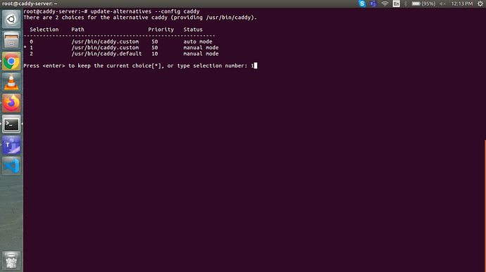

update-alternatives --config caddy
Is this the right command to use custom build?
If you were following the instructions here: Build from source — Caddy Documentation then yes.

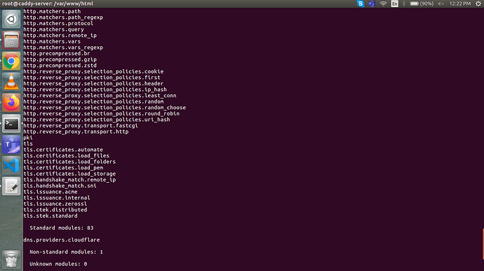

As I asked, what’s the output when you run when you run caddy version and caddy list-modules? That will prove that you did it correctly.
I have checked the output of both caddy version and caddy list-modules commands in both default and custom build.
Version in both the cases -
v2.4.3 h1:Y1FaV2N4WO3rBqxSYA8UZsZTQdN+PwcoOcAiZTM8C0I=
And if I select custom then I am getting dns.providers.cloudflare in Non-standard modules list.
