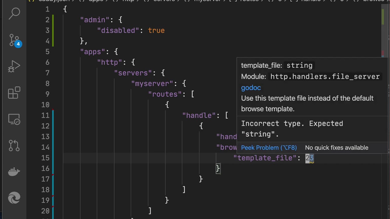

I took some time out to make the experience better for myself and other Caddy enthusiasts and I came up with caddy-json-schema. A JSON schema generator for Caddy v2 that can be integrated with editors to get suggestions and documentation.
Here is a demo of it in action.
I have only tested it with the editors I use personally, VSCode and Vim (with coc-json plugin). But I expect it to work with any editor that supports the use of JSON schema for intellisense.

I found out JSON schemas can also be used for YAML files and the project docs have been updated to reflect it.

I am using it myself because although our online JSON docs are actually quite good, nothing really beats having the editor show it for you as you’re typing. I estimate that this accelerates my config editing by about 2-5x (and this is coming from someone who is more familiar with it than anyone else).
This should lower the “fear” factor that people have when approaching JSON configs quite a bit. I hope more people will use JSON to configure their servers when they need to, without being apprehensive about it, thanks to this plugin. :slight_smile:
