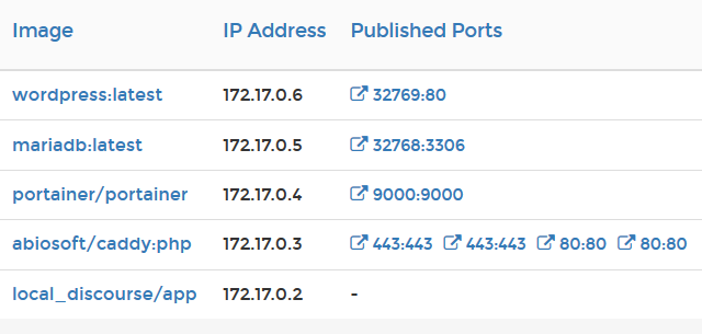

I grabbed a screenshot from Portainer, mainly because it’s more compact than my terminal:
Portainer

    proxy / 9000:80 {
wp.example.com {
  #Wordpress
    proxy / 80:80 {
Since I suspect my Caddyfile is wrong AND I need plugins, getting help on either half of the equation would allow me to dig into the remaining variables. The Caddyfile WP example leads me to believe I still have some work to do beyond just getting the proxy bit right.

This format won’t work. You need a valid host and port to forward to. If you know the IP of the host, you can use that, but I prefer to use Composed networks wherever possible and refer to services by their container name (as shown in the boilerplate example). This way I don’t need to publish any ports other than Caddy’s.
The Caddyfile WP example is for if Caddy were serving WordPress files itself. This would be the case if you downloaded a distribution of WP and unzipped it to your web root and ran Caddy with PHP on-host; you’re running it off the official Docker image instead, which is a prepackaged deal.

      image: abiosoft/caddy:0.10.12
      command: ["-email", "letsencrypt@example.com",
        "-conf", "/etc/Caddyfile",
        "-agree"]
        - 80:80
        - 80:80/udp
        - 443:443
        - 443:443/udp
        - /var/farm/caddy/Caddyfile:/etc/Caddyfile
        - /var/farm/caddy:/root/.caddy
        - /var/discourse/shared/standalone:/sock
      restart: always
Caddyfile
blog.example.com {
  root /var/www/html
  gzip
  push
  errors stdout
  fastcgi / wp-main:9000
Dockerfile
FROM wordpress:4.9.5-php7.2-fpm-alpine
RUN apk add --no-cache \
  libpng-dev \
	wget \
	unzip \
	nano \
	sudo \
	&& docker-php-ext-configure gd --with-png-dir=/usr \
  && docker-php-ext-install gd zip
  # Then more custom config junk
Since the security.limit_extensions is a PHP-FPM thing, I suspect there’s a package or config missing in the Dockerfile. Rewrite? Preliminary googling shows methods for tweaking that extension, but everything so far looks sketchy security-wise.
So I’ll keep researching, and update if I get a solution. Until then, I’m open to suggestions.
Edit: Related thread, but no clear solution.
Change this line from your Caddyfile:
to:
fastcgi / wp-main:9000 php
otherwise, all requests will be proxied to the PHP-PFM listener (not just .php files).
I believe the security limit_extensions errors are appearing when requests for non-PHP indexes or static files are received, which should be handled directly by Caddy and not by the PHP-FPM listener.
Yes, I had it that way before and after posting that Caddyfile example. I guess I just copy/pasted it between tests. The behavior above happens with php added to the line.
I understand what those words mean, but I don’t know how to effect that in Caddyspeak (or Nginx, for that matter, though there are a bunch of examples of Nginx rewrites for WP).
The PHP preset should handle that - only PHP scripts should be sent when the preset is added. Here’s what php does:
ext   .php         # specifies extensions which will get proxied
split .php         # tells Caddy that anything after this goes in PATH_INFO
index index.php    # specifies a default file to try for an index request
So you can see with it enabled (or these settings manually specified - php is just shorthand), no non-PHP file should ever be sent via FastCGI.
Can you double check it’s present in the Caddyfile, restart Caddy, and let me know if the CSS and JS requests still get sent to PHP?
Added this from this write-up:
  rewrite {
      if {path} not_match ^\/wp-admin
      to {path} {path}/ /index.php?_url={uri}
Doesn’t resolve the security error, but it helps with the redirect from https://blog.example.com
