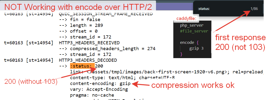

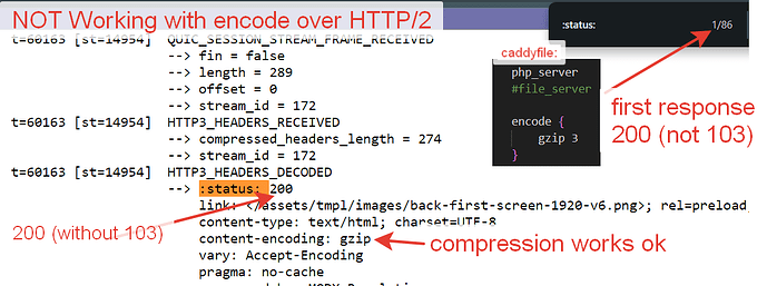

Here is my tests with Chrome v122 chrome://net-export/ and visualize with https://netlog-viewer.appspot.com/:
Not working 103 with encode enabled. Here is first response and it is 200:

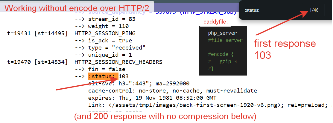

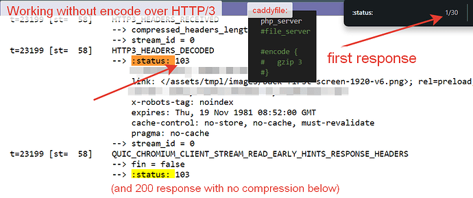

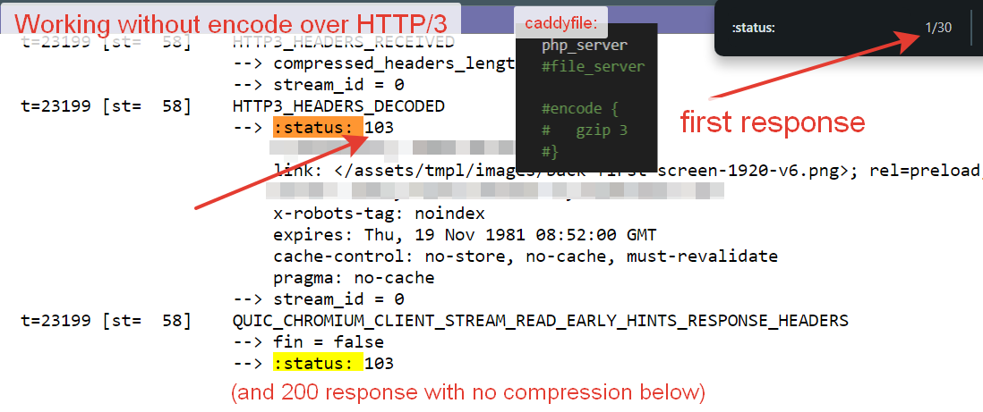

and working, with encode disabled. Here is first response 103 and 200 after:

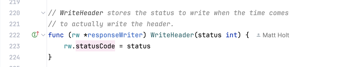

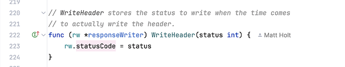

When compression is enabled, the status is not written immediately.

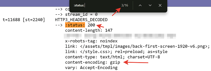

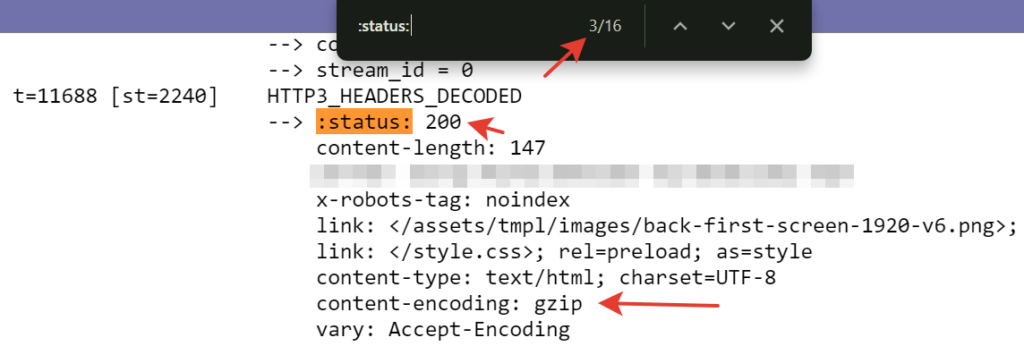

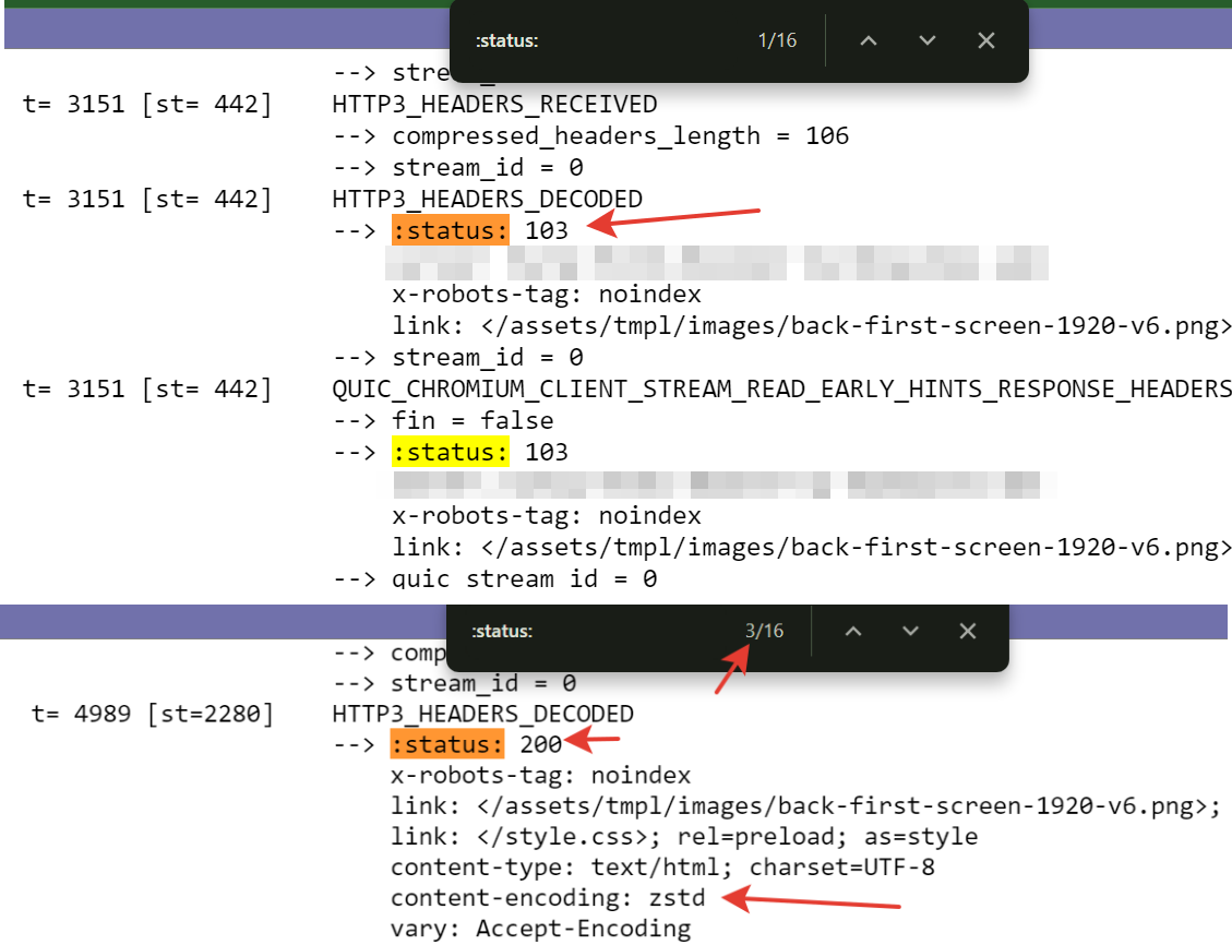

Netlog catched 103 before 200 code, and content encoded with zstd:

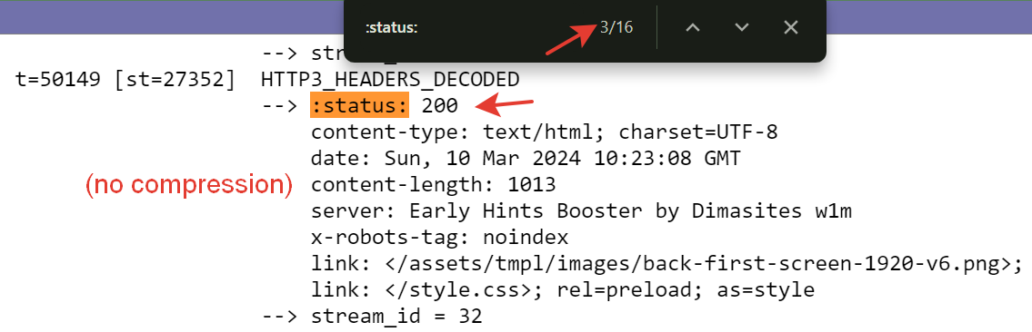

or encoded with gzip:
and i tested without encode, it’s still works :slight_smile: :
