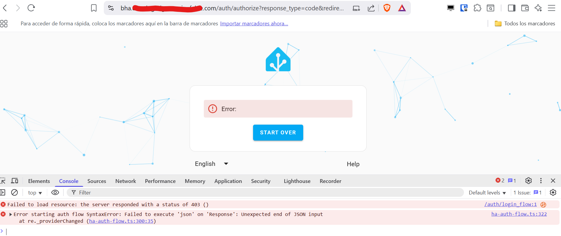

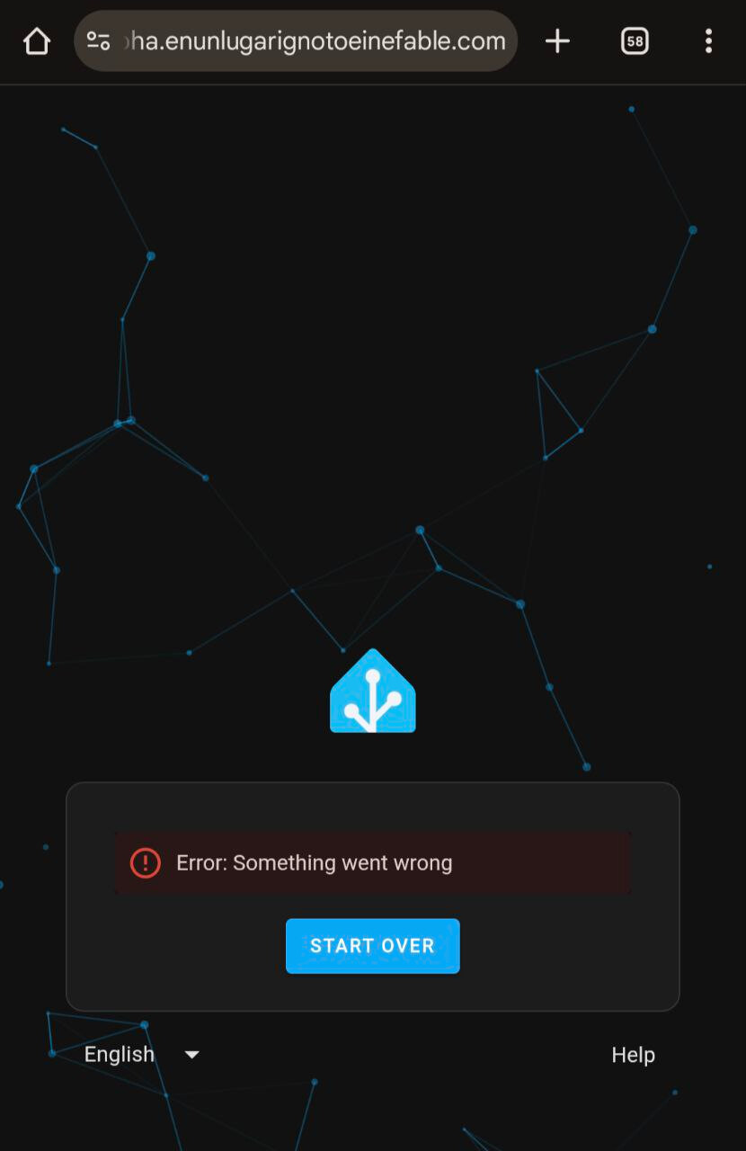

I get something but an error instead de login page.

I can’t find any log where I can find more precise information about the reason why Coraza blocks the connection.
Could you help me find where to look?
Thank you so much

I don’t think the issue now in Coraza. The request is clearly passed to the backend service, Home Automation. I think Home Automation doesn’t like something, and some requests are failing. Open the browser console/devtools (press F12) and look for failures or errors in the Console and Network tab.
I’ll use the dev tools but I pretty sure is coraza because when I comment the coraza lines in Caddyfile, Home Assistant works.
The first connection works, I see it the first page, but after that the user login load page fails.
