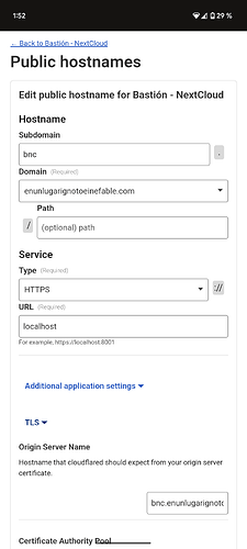

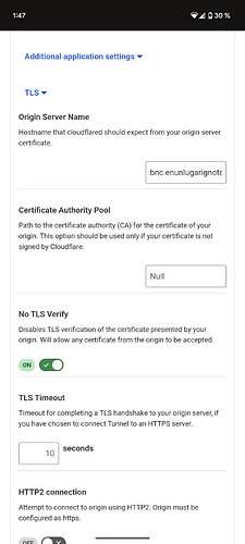

Regarding to question 2, the problem is that there is no way to say cloud flared trust in the self signed certificate to you have to disable TLS verification. (See attached pic)

Is what I just said true? If so, in scenario 2 (which caddy is listening on https - ser picture 2) Shouldn’t that certificate be internal to the tunnel and therefore no one could impersonate it?
If that’s true, wouldn’t it matter if you validate TLS or not?

“Certificate Authority Pool” in your screenshot.
Yes
You’re overcomplicating things. I’ll refer back to what said before about the trust. It’s up to you where you want to draw the line. As long as there’s at least one trusted encrypted connection, you should be OK. Doesn’t matter whether it’s the outer or inner layer. You can have multiple encrypted layers if you wish. But at least one of them should be trusted.
