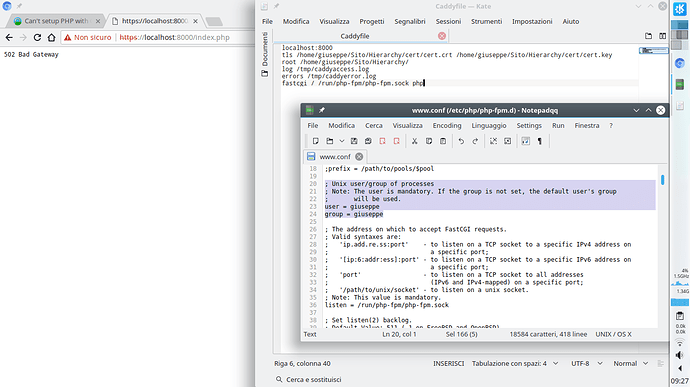

Anyway, as I already said, I tried to set the option you mentioned, but I can’t even see the html page. The only way I can see something is with the configuration I posted in the open post, but php code is still not parsed.
I tried everything, both running caddy from root or my user. php-fpm listen to the socket with http user, buy I also tried to set my user, the result is the same.
http user could not have access to my files, but my user can.
To clarify, the configuration you posted, for a request to /index.php, is identical to not having fastcgi in your Caddyfile at all. You can remove it and see for yourself, it will have the same behaviour (you’ll get the raw index.php).
Caddy can already read the file - it does so when you disable FastCGI for /index.php and Caddy serves it unprocessed.
You need to either change PHP-FPM to run as another user that already has read permissions, or you need to change the files so they are readable by your http user.
Caddy configuration changed as you said and php-fpm listening with my user. php-fpm has to be started as root, can’t be started as normal user, but listening socket wil run as http (or with a custom user, I set it as my user). Nothing changed.

  env SCRIPT_FILENAME /home/giuseppe/Sito/Hierarchy{path}
:smirk:
Hello,
Your root is on /home, did you adjust /etc/systemd/system/multi-user.target.wants/caddy.service ?
Line 17:
ProtectHome=false
To edit a unit, follow this doc: systemd - ArchWiki
You might also have a permission issue (chown/chmod)
