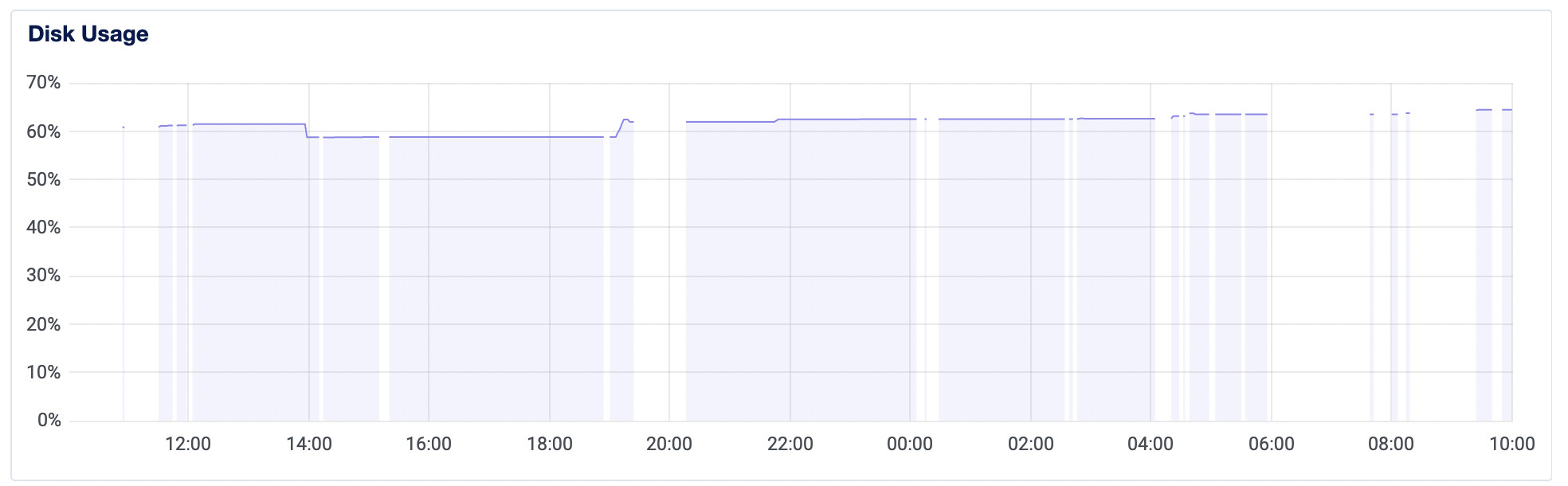

Gah. It was working, but DigitalOcean is doing it again. Here’s a couple snapshots from their own metrics utility:
You can see how it intermittently cuts out. I can’t even SSH into the instance when this happens. It’s like they drop connectivity to the thing entirely and randomly. And I’ve seen this happen with multiple droplets over the last several months. Their support hasn’t been helpful in diagnosing the problem.
I’ll power cycle again. I’m not sure what else to do.

Some builds will succeed if they’ve already been built and are thus cached. Unique builds will fail when the build server is unreachable.
As a long time DigitalOcean enthusiast, this issue is so unfortunate to witness. Their service has been not so great lately.
