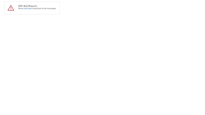

I use Caddy to reverse proxy my unifi controller (version 5.13.29) and receive “400 Bad Request” when I attempt to go to the login page. The previous version of the controller I was running (5.12.66) worked no problem with this config, but after upgrading the controller (running under docker), I started receiving this error
I’ve seen other posts about this error, so I tried adding the -Authorization and passing the Host along in the Caddyfile, but it didn’t have any effect. I can reach the controller if I go to the 8443 (the non-proxied, direct port) and it works normally.
Added logging to the the Caddyfile thinking that it was possibly another header related issues, but only seem to get the requests from client → Caddy, which all show 200 OK.
Is it possible to log the upstream requests (caddy → unifi) so I can see what is happening between Caddy and the controller?

Unfortunately this didn’t have an effect. I did see in the release notes for the new version of the controller (https://community.ui.com/releases/UniFi-Network-Controller-5-13-29/d7647910-77a2-4e61-bbfe-389206f2d6ad) this note:
Regenerate self-signed certificates for existing installations to meet Apple's new rules (see Apple's article HERE).
If the upstream server changed their certs, would that somehow affect Caddy? I would think that since I’m using tls_insecure_skip_verify in my reverse_proxy, it would accept any changes (if it even cared about HSTS for example).
Edit: another thought: can you set the TLS versions and ciphers that are used by the reverse_proxy upstream? I noticed in the debug that all requests, whether they were upstream or from http.log.access.log0 show TLS version 772 (1.3), which I’m pretty sure isn’t supported by unifi’s java server. So I tried setting min and max to 1.2, but it still failed, however I noticed it is picking ciphersuites that probably aren’t supported either (i.e. ChaCha).

You would not receive Status 400 Bad Request from the controller if this error was occurring at the transport layer. You would get Status 502 Bad Gateway, from Caddy itself. From the Status 400 we can infer that the issue is with the HTTP request itself, not TLS negotiation.
Good point, the controller is displaying the error page, so that piece should be fine. I was thrown off that the debug log was reporting 1.3.

Hmm! That’s annoying, because the logs don’t show any 400s. In fact, every one of those logs (other than a single 302 redirect) is a 200 OK. Rather rude for the Unifi controller to say “all good!” to Caddy while giving you a page which itself says “bad request!”.
