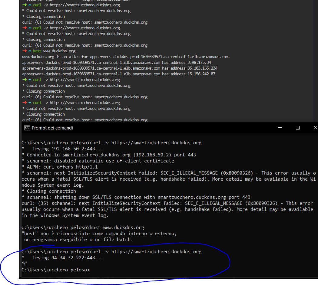

That means you’re bypassing Caddy entirely. You’re making requests directly to those apps.
What do you see when you run this:
curl -v https://smartzucchero.duckdns.org
Is Caddy running on the same machine as your apps?
Show your Caddy logs.

This tells me that the system you ran this on has misconfigured DNS resolvers. Not a Caddy problem, it’s a problem with your system’s configuration.

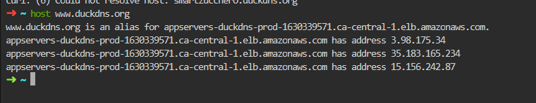

Try running this command, what do you see?
$ host www.duckdns.org
Here it is the Command:
Okay, that’s good :thinking: And this is on the machine running Caddy?
Yes, it is on that machine. I m investigating the issue on the DNS.
I found that i configured a custom resolution for smartzucchero.duckdns.org and also *.smartzucchero.duckdns.org .
I will try to remove these, and perform again the tests.
It’s fine to have this (to override DNS in your LAN to point to your server’s IP instead of your WAN IP), but it needs to actually resolve. Your command was showing that it was resolving to nothing.
Removing the DNS resolution (the blue circled part) the dns resolution is not working from another windows machine (that was able to resolve it in the win prompt upper part, when there was the DNS custom resolution).
In the grey part (on the same machine where caddy is), nothing changed.
What should i look for?
