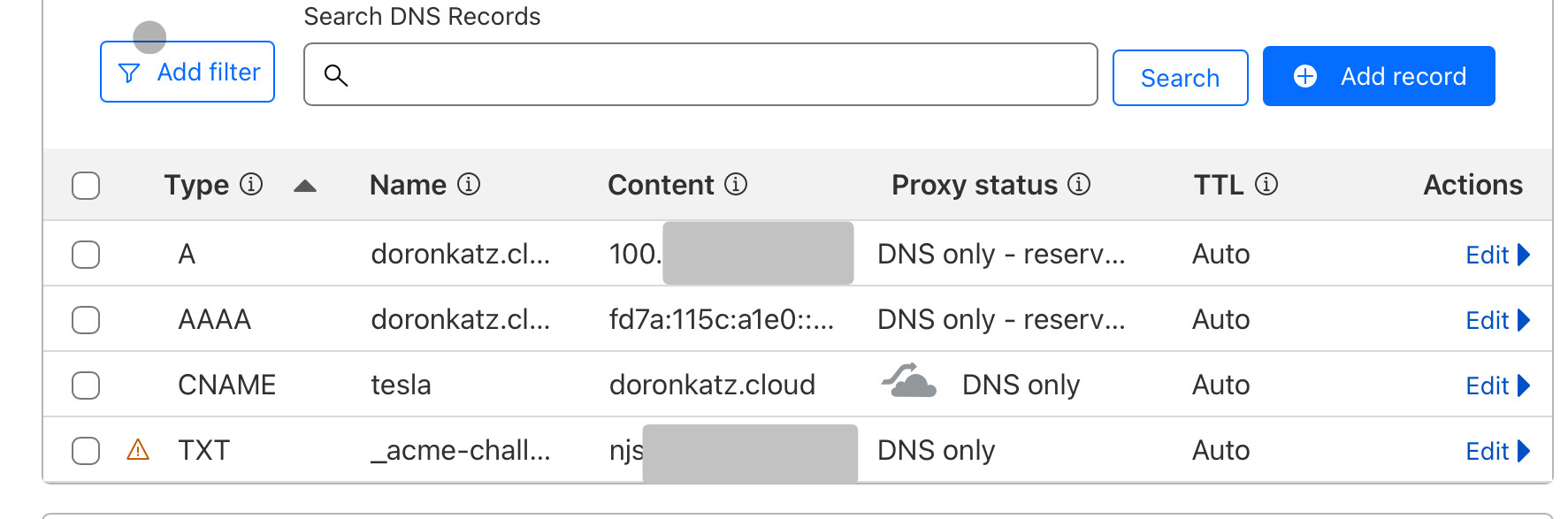

I was trying to follow an example from How to securely access homelab with Tailscale — Evgenii Burmakin on the setup, but changed it slightly as I experimented.
Other than that, my DNS I use is cloudflare. My DNS settings are as follows:
