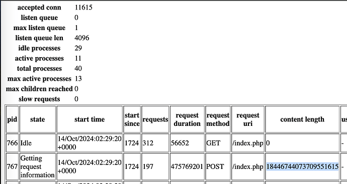

Hi @matt,
you were absolutely right with the PHP backend. I did not think about it because I assumed a gateway related error would have appeared, but that was and is not the case.
To back it up, here are at least the curl responses to compare backend and static request:

I’ll mark your comment as solution because it clarifies that that caddy is working just fine and is not the “culprit” in this case. Apart from that, I have to further investigate why PHP is suddenly stopping responding.
One thing that still baffles me is that, the issue gets resolved by either restarting Caddy or PHP. If PHP is misbehaving, why does a restart of Caddy solves it? It makes, however, completely sense if PHP is broke, restating it fixes it. Because PHP is lower in the food chain, I suspect thus the calamity here,…
To give a little background on the setup/configuration: PHP is configured as static processes with a few children of 8 and max_requests of 500, because it did not need more than that (over a timespan of 4 years) and therefore I could give more resources to MySQL, that needed quite a lot. I’ve recently upgraded the server and have now increased the max_children to twice the size. Time will tell if that solves the underlying issue - but I doubt that :wink:
PS.: I did check whether the PHP processes gets respawned or not and to rule out that a process is eventually not available. Unfortunately, there were 5 idle processes when PHP did not respond, so it’s unlikely that.
I’ll keep digging + thanks for your help.
I had a similar issue to this - also using Ubuntu, Caddy, PHP-FPM.
I never found the cause of the problem, tried multiple versions of Caddy and PHP-FPM.
I’ve sinced ditched PHP-FPM for FrankenPHP which has been running fine without the problem :slight_smile:
Description of issue:
Perhaps checking the PHP-FPM status page can give you more insight.
we’re getting the same issue right now, thank you @jeremyj11 for spotting this, has been driving me nuts. seems like an infinite POST. php.ini has ‘post_max_size’ set to 32M but the request size is way bigger. both caddy and php-fpm stay running fine but Caddy just stops responding, maddening. I will try max_size in caddy and report back
Is that request body being downloaded by Caddy indefinitely? Or is the request body small/normal-sized/empty, and Caddy is just hanging?
I guess this might be a slowloris attack, because it eventually consumes all PHP-FPM resources. last night I sleepily put this in:
request_body {
	max_size 1MB
This morning, there were still tons of hung requests on POST “getting request information”
So I have added these:
servers {
	timeouts {
		read_body   70s
		read_header 70s
		write       70s
		idle        70s
... inside matching block
php_fastcgi 127.0.0.1:9000 {
    read_timeout 70s
    write_timeout 70s
now I am watching the “Getting request information” requests come in and they eventually get cleared, hallelujah. not sure which of those is working, I will try with just the fastcgi timeouts. it’s been days of debugging to find this issue… can I suggest putting a default like 60s in your opinionated php_fastcgi directive? I would have much rather tracked down a 60s upload or download timing out down the line, than intermittently getting downtime due to this. to be fair I had this in my nginx config, and there’s a good chance it took me just as long to figure that out too.
   # slightly longer than PHP execution timeout (60s)
    fastcgi_read_timeout 70s;
    fastcgi_send_timeout 70s;
