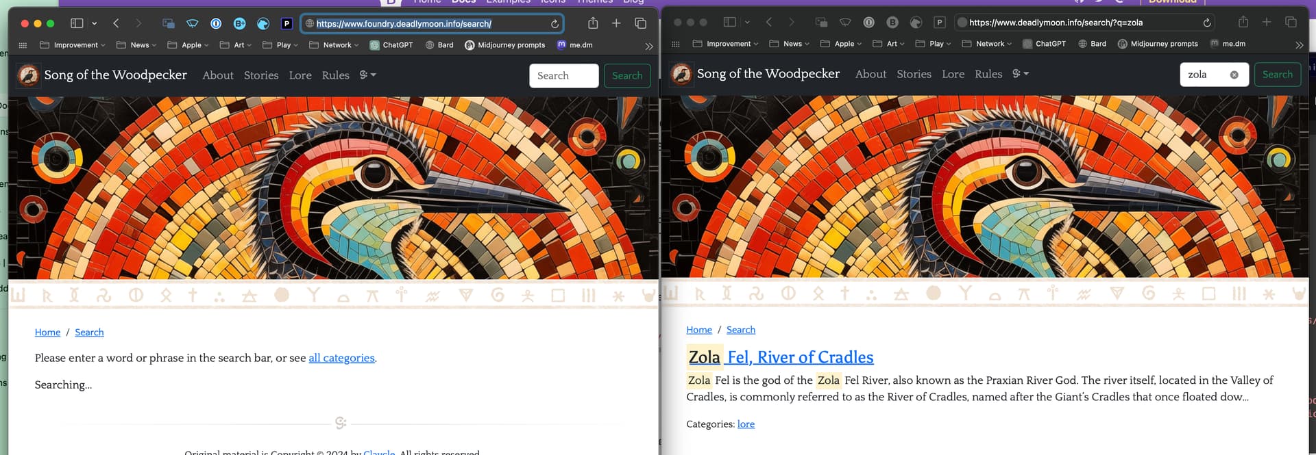

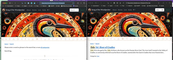

I am serving a static website (built with Hugo) on a “simple” caddy server in AWS Lightsail (Ubuntu). All has been going swimmingly until I wanted to add a search function to my website. This is handled by sending a QueryString “?q=foobar” to a search URI on the website (mysite/search?q=foobar).
This all worked just fine on localhost, but then I deployed to my AWS server with caddy and searches failed (nothing was found). I spent many hours scratching my head, trying to figure out what I was (or Hugo was) doing wrong and searching the web for answers. In my gyrations, I noted that the URI was being stripped of the querystring.
I finally though to try hosting the site on another webserver I had, that has a basic deployment of Apache on it.
And it worked perfectly. The querystring was not stripped from the URI and the search page functioned as expected.
Unfortunately, I don’t know why Caddy is doing this (presumably it’s Caddy), what magic words I need to invoke in searching the web to find documentation on it, or what I need to add or change in my configuration to make it work.
So I am asking for a clue for $100, Alex.
There are no errors. Caddy is just stripping the querystring off the URI???

Finally, you can compare the sites, with identical deployment bases, and see how they respond differently:
Caddy Version: https://www.foundry.deadlymoon.info
Apache Version: https://www.deadlymoon.info
Using the search box on the caddy version will see the querystring stripped, but not on the apache version.
Image:
