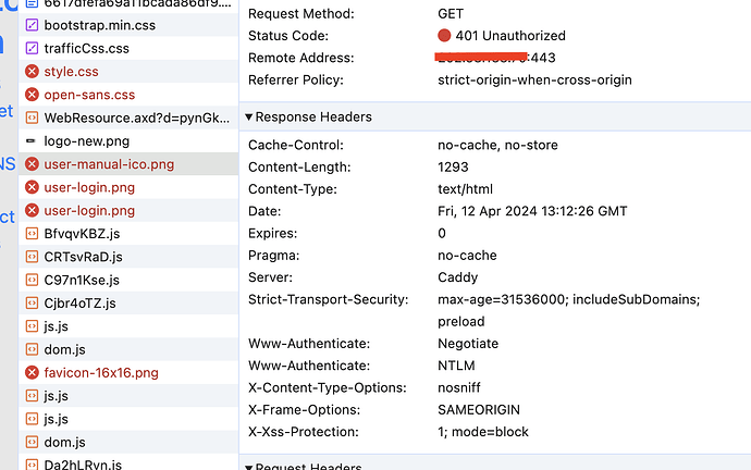

NTLM based application repeatedly keeps asking for authentication (401).
As you can see, after I enter the credentials couple of requests go through but then 401 response along with Www-Authenticate: Negotiate is back. As far as the client is concerned login doesn’t work

Here are two entries (from caddy debug logs) where the first log is after authentication is successful but immediately follows with 401. Its like as if the backend server suddenly decides this is not the same user as before
{"level":"debug","ts":1712981254.1765645,"logger":"http.handlers.reverse_proxy","msg":"upstream roundtrip","upstream":"etest.wns.com:443","duration":0.020057676,"request":{"remote_ip":"X.X.X.X","remote_port":"54236","client_ip":"X.X.X.X","proto":"HTTP/3.0","method":"GET","host":"etest.wns.com:443","uri":"/Resources/bootstrap/css/bootstrap.min.css","headers":{"Accept":["text/css,*/*;q=0.1"],"Sec-Fetch-Mode":["no-cors"],"X-Real-Ip":["X.X.X.X"],"Accept-Encoding":["gzip, deflate, br, zstd"],"X-Forwarded-For":["X.X.X.X"],"Referer":["https://6617dfefa69a11bcada86df9.SLUG-38.gw.DOMAIN.io/"],"Sec-Ch-Ua-Mobile":["?0"],"Cookie":[],"User-Agent":["Mozilla/5.0 (Macintosh; Intel Mac OS X 10_15_7) AppleWebKit/537.36 (KHTML, like Gecko) Chrome/123.0.0.0 Safari/537.36"],"Sec-Fetch-Site":["same-origin"],"Sec-Ch-Ua":["\"Google Chrome\";v=\"123\", \"Not:A-Brand\";v=\"8\", \"Chromium\";v=\"123\""],"Sec-Fetch-Dest":["style"],"Dnt":["1"],"Pragma":["no-cache"],"X-Forwarded-Proto":["https"],"X-Forwarded-Host":["6617dfefa69a11bcada86df9.SLUG-38.gw.DOMAIN.io"],"Accept-Language":["en-US,en;q=0.9"],"Cache-Control":["no-cache"],"Sec-Ch-Ua-Platform":["\"macOS\""]},"tls":{"resumed":false,"version":772,"cipher_suite":4865,"proto":"h3","server_name":"6617dfefa69a11bcada86df9.SLUG-38.gw.DOMAIN.io"}},"headers":{"Cache-Control":["no-cache, no-store"],"Persistent-Auth":["true"],"Date":["Sat, 13 Apr 2024 04:07:33 GMT"],"Content-Length":["32182"],"Content-Encoding":["gzip"],"Expires":["0"],"Vary":["Accept-Encoding"],"X-Frame-Options":["SAMEORIGIN"],"Strict-Transport-Security":["max-age=31536000; includeSubDomains; preload"],"Pragma":["no-cache"],"Content-Type":["text/css"],"Last-Modified":["Fri, 22 Dec 2023 15:29:02 GMT"],"Accept-Ranges":["bytes"],"Etag":["\"c93c8c97eb34da1:0\""],"X-Xss-Protection":["1; mode=block"],"X-Content-Type-Options":["nosniff"]},"status":200}
{"level":"debug","ts":1712981254.1861625,"logger":"http.handlers.reverse_proxy","msg":"upstream roundtrip","upstream":"etest.wns.com:443","duration":0.029091655,"request":{"remote_ip":"X.X.X.X","remote_port":"54236","client_ip":"X.X.X.X","proto":"HTTP/3.0","method":"GET","host":"etest.wns.com:443","uri":"/Resources/StyleSheet/style.css","headers":{"X-Forwarded-Host":["6617dfefa69a11bcada86df9.SLUG-38.gw.DOMAIN.io"],"Pragma":["no-cache"],"Cache-Control":["no-cache"],"X-Forwarded-Proto":["https"],"Accept-Language":["en-US,en;q=0.9"],"Sec-Fetch-Site":["same-origin"],"Sec-Ch-Ua-Platform":["\"macOS\""],"X-Real-Ip":["X.X.X.X"],"Sec-Ch-Ua":["\"Google Chrome\";v=\"123\", \"Not:A-Brand\";v=\"8\", \"Chromium\";v=\"123\""],"User-Agent":["Mozilla/5.0 (Macintosh; Intel Mac OS X 10_15_7) AppleWebKit/537.36 (KHTML, like Gecko) Chrome/123.0.0.0 Safari/537.36"],"Sec-Fetch-Dest":["style"],"Sec-Fetch-Mode":["no-cors"],"X-Forwarded-For":["X.X.X.X"],"Sec-Ch-Ua-Mobile":["?0"],"Accept":["text/css,*/*;q=0.1"],"Referer":["https://6617dfefa69a11bcada86df9.SLUG-38.gw.DOMAIN.io/"],"Accept-Encoding":["gzip, deflate, br, zstd"],"Cookie":[],"Dnt":["1"]},"tls":{"resumed":false,"version":772,"cipher_suite":4865,"proto":"h3","server_name":"6617dfefa69a11bcada86df9.SLUG-38.gw.DOMAIN.io"}},"headers":{"Pragma":["no-cache"],"Content-Type":["text/html"],"Www-Authenticate":["Negotiate","NTLM"],"X-Xss-Protection":["1; mode=block"],"X-Frame-Options":["SAMEORIGIN"],"Strict-Transport-Security":["max-age=31536000; includeSubDomains; preload"],"Date":["Sat, 13 Apr 2024 04:07:33 GMT"],"Content-Length":["1293"],"Cache-Control":["no-cache, no-store"],"Expires":["0"],"X-Content-Type-Options":["nosniff"]},"status":401}
