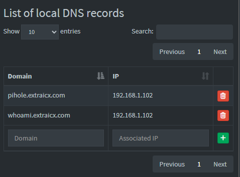

Pihole Local DNS records:
It says it failed to issue certificates because the DNS records weren’t there. Try to increase the propagation delay?
