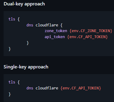

I personally don’t use Cloudflare, but shouldn’t there be both an API token and a zone token? So it would be like this:
*.ext.consultoria-as.com {
		issuer acme {
			dns cloudflare {
				api_token CF_Token_Redacted
				zone_token your-zone-token
			resolvers 1.1.1.1

Regarding the suggestion of adding zone_token; per the guide, that is needed if I was using the 2 token approach, but in my case I have a single token with all the permissions needed for CloudFlare to update records
