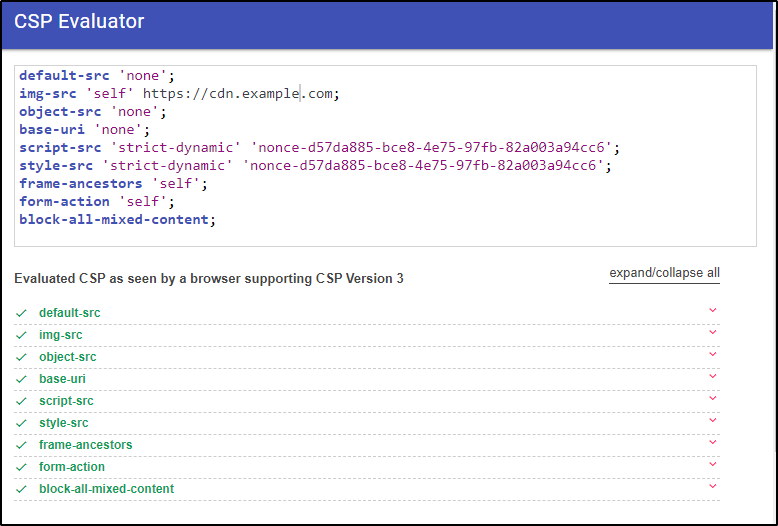

I have slightly modified the browse template because I wanted to have a CSP as well. My CSP looks like this:
default-src 'none'; img-src 'self' https://cdn.example.com; object-src 'none'; base-uri 'none'; script-src 'strict-dynamic' 'nonce-6a1cb651-83bc-496a-94d0-fef81de5cb3d'; style-src 'strict-dynamic' 'nonce-6a1cb651-83bc-496a-94d0-fef81de5cb3d'; frame-ancestors 'self'; form-action 'self'; block-all-mixed-content;
which is rated by Google CSP evaluator like this:
The CSP Nonce is created like this in the first lines of the browse.html:

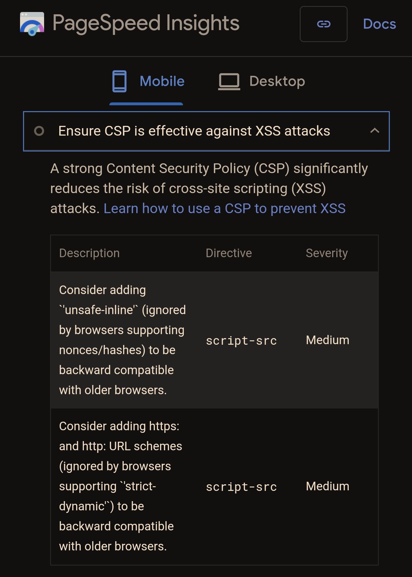

Google PageSpeed recommend adding unsafe-inline, http and https CSP to be compatible with older browsers. What do you think about that?
That makes sense :+1:

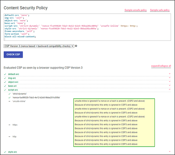

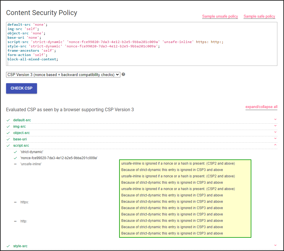

These values for backward compatibility with older browsers have been added.
https://csp-evaluator.withgoogle.com/ also suggested these, and now it looks better:

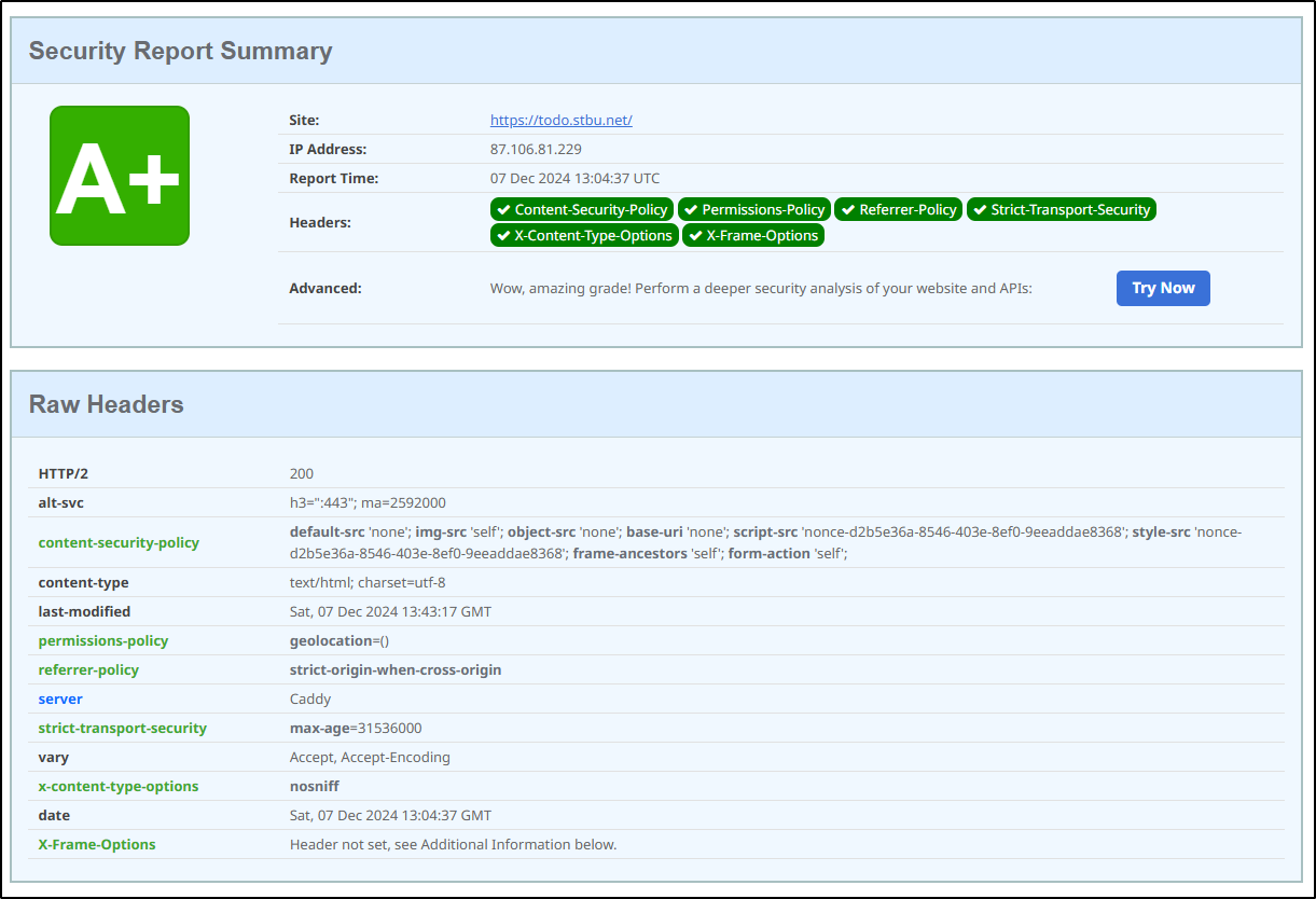

This is how the Content-Security-Policy from Caddy v2.9.0-beta.3 browse will be rated on Securityheaders.com:
That was my temporary (already reverted) Caddyfile for above test:
todo.stbu.net {
                Permissions-Policy "geolocation=()"
                Referrer-Policy "strict-origin-when-cross-origin"
                X-Content-Type-Options "nosniff"
                Strict-Transport-Security "max-age=31536000"
        file_server {
                root /home/stbu/caddy-prod/browse-test/test-dir
                browse
