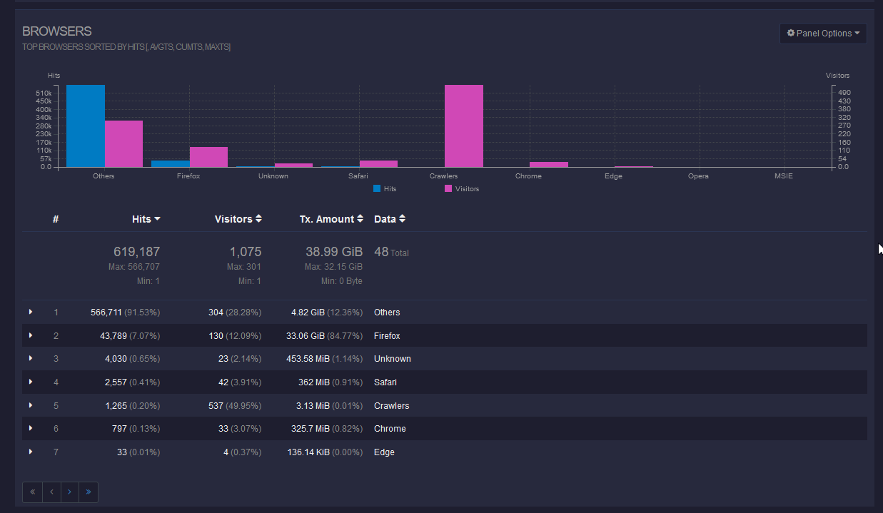

GoAccess logs browser access if you change the Caddy logging format to {combined}
e.g.
example.com {
log / /path/to/caddy.log "{combined}"
And in your GoAccess configuration, specify log-format COMBINED
e.g.
example.com {
