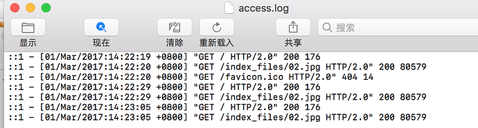

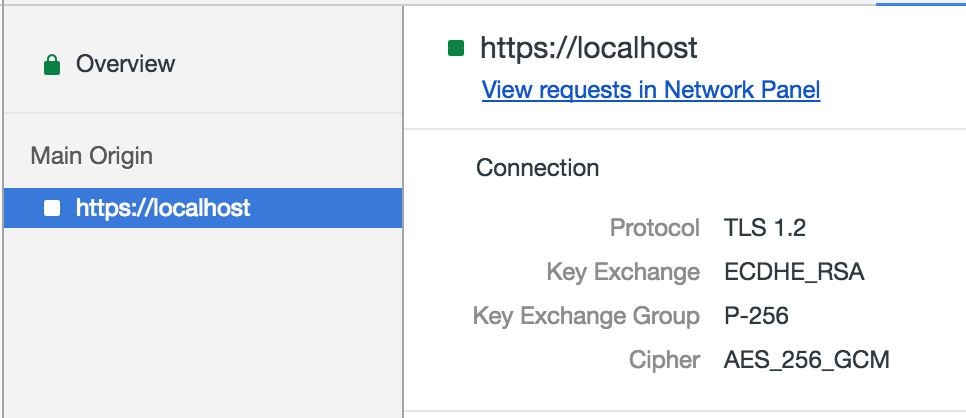

I trie matt.life in my chrome with no plug-ins, with quic enabled,
but when I access matt.life, it shows that it is run on HTTP2 protocol, not quic!

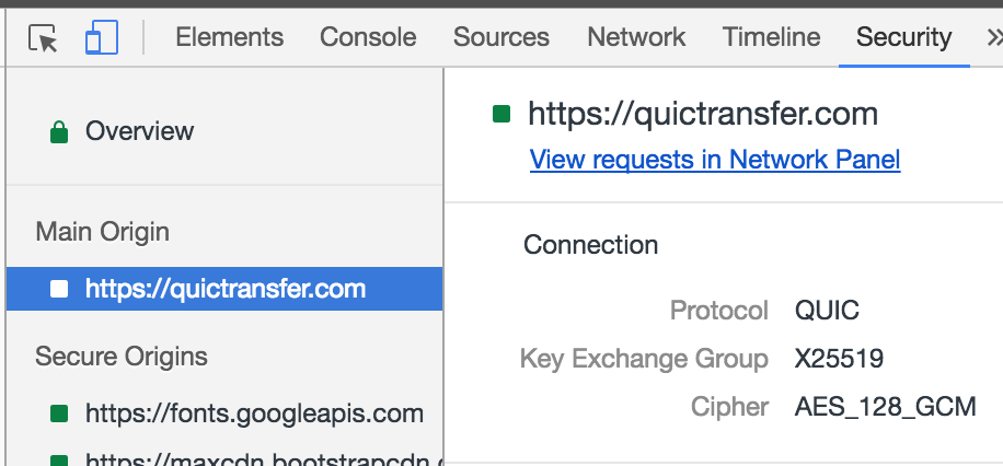

But when I access quictranfer.com, it actually shows that it is running quic.

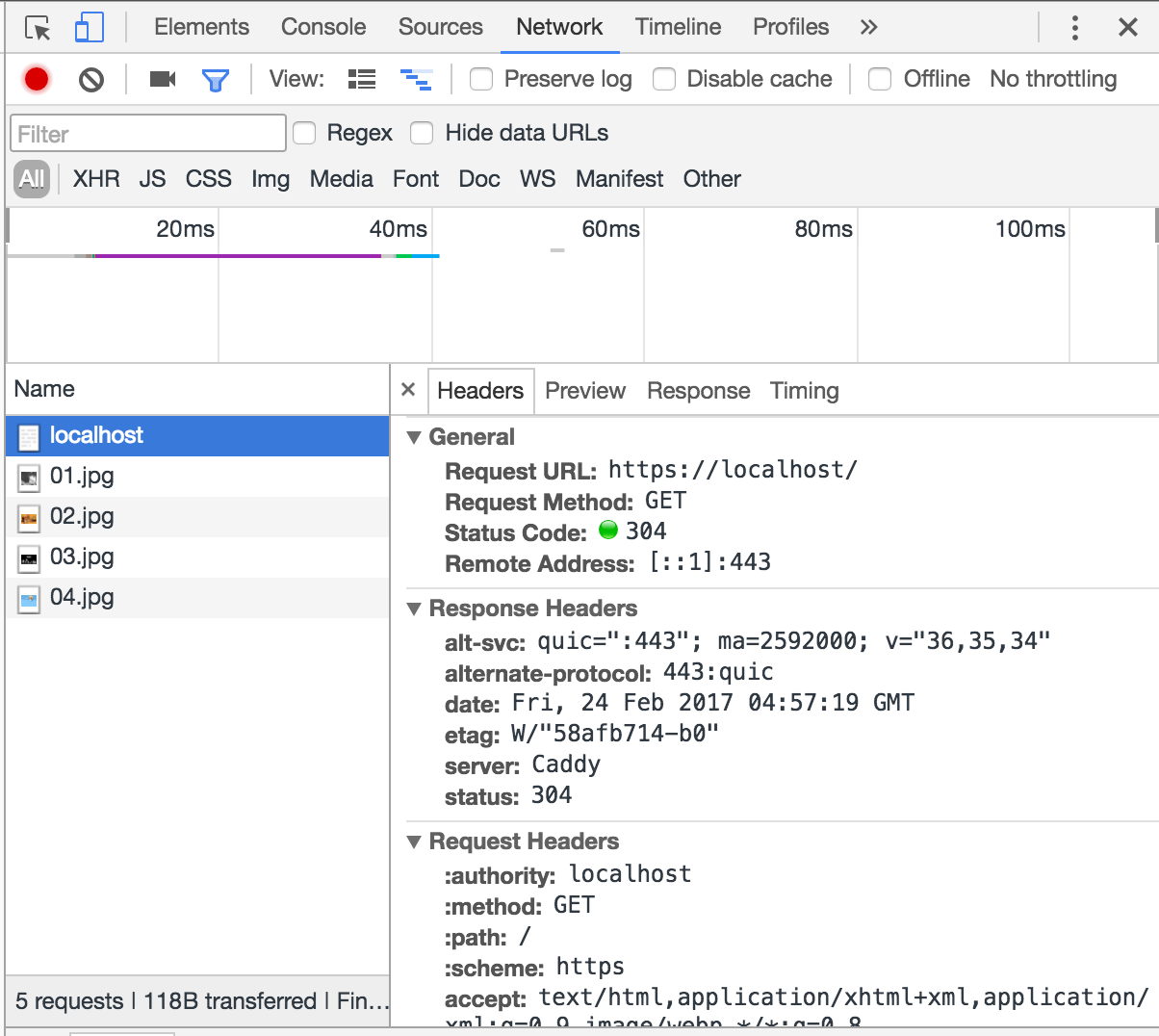

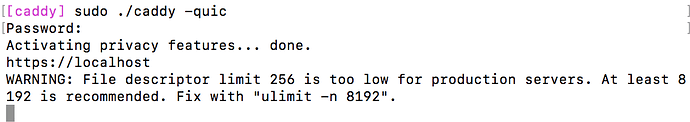

I run caddy with -quic in command line and the response header involve
alt-svc:quic=":443"; ma=2592000; v=“36,35,34”
alternate-protocol:443:quic
But I could only find it running HTTP2 with self-signed CA.

localhost:443 {
tls CertificateGenerator/out/leaf_cert.pem CertificateGenerator/out/leaf_cert.key
root example
log access.log
my server and client are both on my computer.
